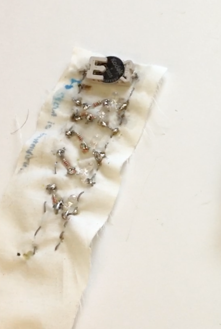

Step 2: STEP 2: Start Sewing Your Circuit
You will need a battery holder which will help you connect the thread to either end of the battery.
First, connect the battery and then sew two long rows of connected stitches.
Note: there should be a BREAK in one of the rows of stitches.
What does this mean? Sew a few stitches that connect the battery, tie a knot and cut the thread. Then a few cm away, start the row of stitches again. See first photo.
This gap in your circuit is where the pressure sensor you make will be attached. Keep that in mind, but don't worry about it at the moment.
After you have the two lines sewn, start to use more conductive thread to connect the resistor and the leds. The resistor and LED should bridge and connect the two initial lines you sewed. See second photo. It should look like a ladder of LEDs and resistors.
So how do you test this to see if it's working?
Connect a the break in your circuit with a piece of conductive thread or copper fabric. If the lights turn on, then your circuit is working! If not, check all connections and solder all the points of connection to ensure maximum stability.
