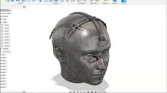

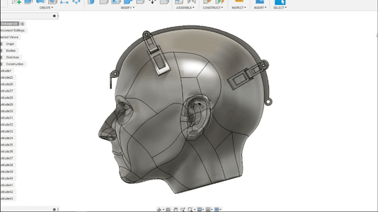

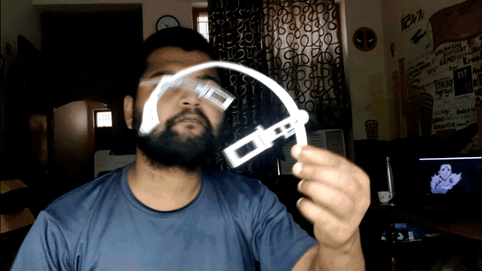

Step 2: Design
Frame or "highly edited headband" consists of the main arc shape that has four holding levers for supporting and gripping the front top part and back part of the head.
Each Lever is made from two parts connected, Lever itself and the supporting part.
These levers can easily rotate so if the user's head is a little bit large, he can adjust the fitment by rotating the lever according to his or her head.
In the front, there's an LCD Holding part that is designed to hold the round LCD by using its two screw mounts.
PS- This structure is designed by using a normal-size head file.

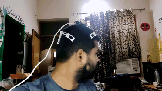

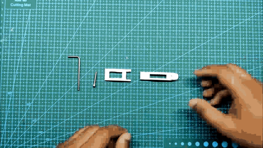

Step 4: Head Frame Assembly
  • We start the assembly by first connecting the lever with its support part by using an M3 Nut and bolt, we prepare three more lever-support setup so we can assemble them with the main arc.
  • Next, we connect the lever-support setup with the main arc structure by using slightly longer M3 nuts and bolts.
  • The frame is now ready.

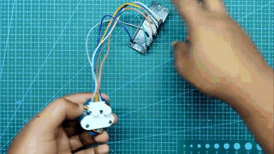

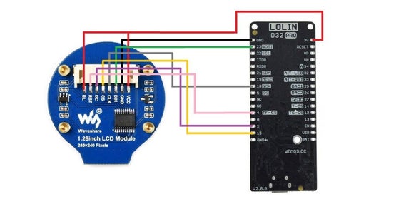

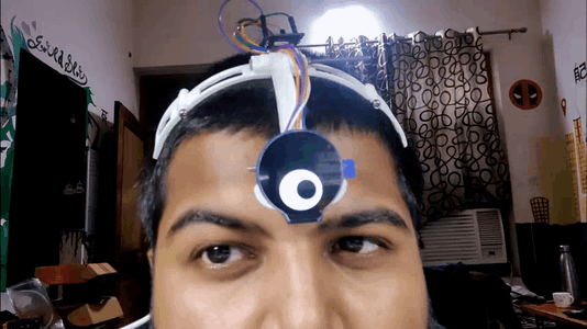

Step 5: Round Display and ESP32 Setup
Next, we prepare the ESP32 and LCD Setup by connecting both with the provided wiring diagram. I also added the LCD Holder to Round LCD before the main assembly even started (just to save time).
Step 6: Main Assembly
  • We first start by connecting the LCD Holder with the front side of the frame
  • Next, we add ESP32 in the middle by using a zip tie
  • After that, we add Kapton tape to neatly bind the wires to the frame body, zip tie can also be used here just make sure not to squeeze wires tightly or they will get damaged and lose their continuity.
  • Third Eye setup is ready, next we add code into the ESP32.

Step 8: Result
This will be the result after adding the code to the ESP32.
As you can see, there's a different UncannyEye displaying on the LCD Screen, that's because the uncanny eye sketch contains a bunch of other eyes that we can switch by changing the below code in the config file.
