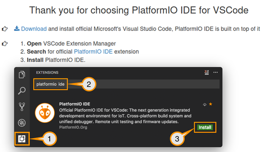

Go to https://platformio.org/platformio-ide and follow the installation instructions.
In PlatformIO IDE click "Clone GIT repository" and paste the following URL:
https://github.com/arduinocelentano/smartclock-photoframe
PlatformIO should automatically download the project and the libraries it depends on.

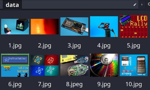

You should convert your photos to JPEG and resize them to 240Γ—240. They should be called 1.jpg, 2.jpg, 3.jpg, etc.
To do this automatically, you can use the following Bash + Imagemagick script. You can change the JPEG_QUALITY constant to accommodate more photos.

Copy the images to the project's data directory and set the IMAGES_COUNT constant in main.cpp. For example, if you have 150 images, it will look like this:
