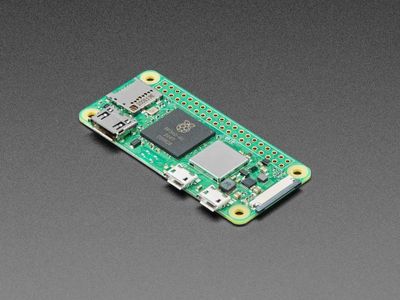

You can find the files for this project on my Printables. The 3D printed parts were designed in Tinkercad. Print one of each part. Once they are printed, place the raspberry pi on top of the bottom piece, lining up the posts with the holes in the raspberry pi.
Step 2: Put in the USB Adapter
Take the USB adapter and put it into the USB port closest to the micro SD card port. It is very important that you put it in this port and not the other port because the other port is power only.

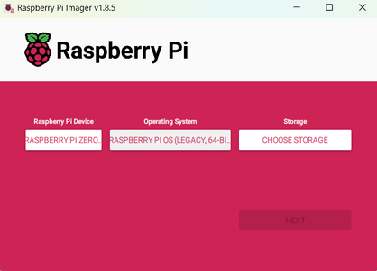

Step 3: Flash the Raspberry Pi
Open the Raspberry Pi Imager and select Raspberry Pi 0 2 W from the choose device dropdown menu. Next, open the choose OS menu and select Raspberry Pi OS (other). From there, choose Raspberry Pi OS (Legacy, 64-bit) Lite. Then choose your SD card from the choose storage menu. Finally click next, make sure you modify your settings so that you raspberry pi can connect to your wifi, and apply customization settings. Once it's done, plug the SD card into the raspberry pi.

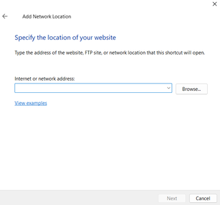

Now for the whole reason we made this NAS: lets add some files to our folders! To do this, open the file explorer and go to This PC. Right click and choose Add a Network Location. Click Next, and then Choose a Custom Network Location. Type in the following:
\\yourip\yoursharedfolder
So I would type in \\192.168.0.17\main. Next it will ask you to put in your username and password. Once you do this, you will be able to see the files already in the shared folder and add files of your own. Congratulations! No longer do you have to pay for more storage in the cloud or try to delete all the files you don't need off you computer.
