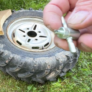

  1. Remove the valve stem core, and let the air out of the tire. I have a tool for this, but I've done it before without one. If you don't want to buy the tool, I'm sure you can find good instructions for removing the core without one.

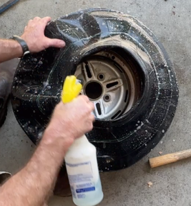

Step 4: Remove the Tire (from the Valve-Stem-Side of the Rim)
  1. Place the tire on the ground, valve stem facing up. You only need to remove this side of the tire from the rim.

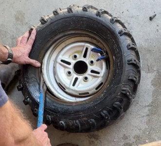

  2. Spray the tire and rim liberally with soapy water (to facilitate the sliding/stretching that needs to happen).

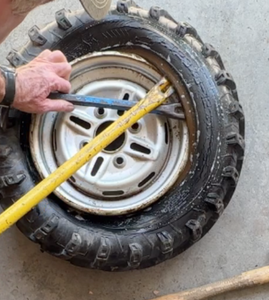

  3. Use a pry bar to pry the tire bead out and over the edge of the rim.
  4. Insert the pry bar so it s its on top of the rim and under the lip of the tire.
  5. Insert a second pry bar in the same manner, but at an angle to the first prybar, and on top of the first pry bar. The bottom pry bar serves as a fulcrum for the top one.
  6. Use the top pry bar to lever more tire over the lip of the rim.
  7. Shift the two prybars around the rim until all of the tire is over the edge of the rim.

  1. Spray the tube and tire liberally with soapy water.
  2. Orient the tube so that the valve stem points up.
  3. Insert the tube into the tire.

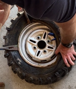

  4. Get the valve stem in place (through the hole in the rim). If it has nuts, use the nuts to secure the valve stem in place. If it doesn't, find a clamp (red circle in photo) that won't damage the valve stem, and use it to keep the valve stem sticking out of its hole.
  5. Start stretching the tube around the rim. Mine wasn't super-easy, but it wasn't too bad.
  6. Use a stick of wood, sprayed with soapy water, to lever the tube around the rim. The stick that I used had dimensions similar to a thick ruler.

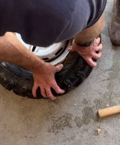

Begin stretching the tire back over the rim. I used the pry bars to get started, and then I did some pushing with my hands. Do as much as you can without over-exerting yourself. I think that if you can get more than half-way there, you can use the tire horn to do the rest.

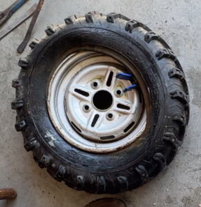

  2. Fine-tune the positioning. Part of the tire is tucked nicely into the rim, and part of it's still out. Find one of the two places where the tucked-in and not-tucked-in parts meet (red mark in the picture). I rotated the tire until one of those spots was close to the center of the tire horn's crescent (blue mark in diagram).
  3. Drive slowly up the ramp. The first time I did this, I put the brake on, got out, and watched the tire stretch over the rim in seemingly slow motion. When I did the second tire, it was much more abrupt.
  4. The second picture shows the tire under my car's full weight. You can see that not all of the tire is inside the rim at that point, but when I backed off, the tire's tension pulled that last part in.
