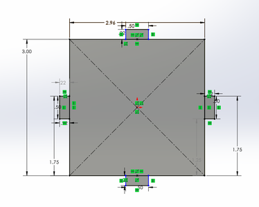

(These Parts are Solidworks Files ".SLDPRT", if you have Solidworks you can save the files as ".STL" and 3D print all of the parts. These parts have the same width as the Baltic Birch.

All of the Parts are Included, in both ".STL" and ".SLDPRT / .PRT" All of these are Free and Designed by me. You are free to change or edit any proportions that you want.

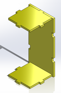

Let's Start with connecting Parts to the small side, Shall we?

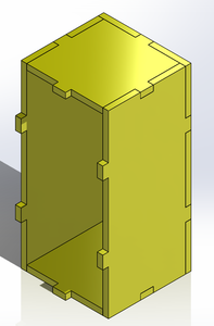

- Look at the Image labeled "Step One". As you can see not all of the sides are the exact size due to the Design of the Speaker. The Smaller Side connects to the Back Piece, either side works. Do this Two Times. Your Piece should look like "Step One Complete"
- This is where the Piece "Traffic Light Long Sides" are used. Look at "Step Two" This is what the Long Side Piece looks like. In "Step One Complete" you can see that the Small sides need to be connected to the Long Sides. These Pieces are connected the Exact Same way that the Back is connected, but this time on the sides. Connect the Long Sides to the Smaller Sides As shown in "Step Two Complete"

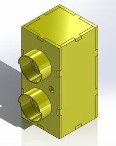

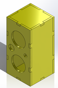

- The Front Piece or Face can be connected or flipped any way that you want. So if you want the Power switch on the left you can move the piece. Your Print In Person should look like "Step Three Complete"
- (Optional) If you want to you can Add the "Hoods" to the Assembly, But these aren't needed. Just attach them like "Step Four Complete". Mind You that these stay in via Friction, so if they don't stay put then you can sand them down. (I recommend using 220)
