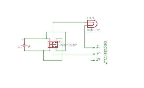

In this circuit, we want to switch the direction of the voltage and see when the circuit becomes conductive. To do so, we will use a rocker switch. The rocker switch circuit is a simple example of a H-bridge circuit (it can switch direction of the voltage).
So, now by using the rocker switch you can pull either the base or the emitter/collector to VCC by switching the voltage direction. The bulb is connected in series with rocker switch and the Transistor. So, if the Transistor is NPN and base is pulled to VCC, the bulb would glow. Similarly, if the Transistor is PNP and base is pulled to GND the bulb would glow. Please refer to the diagram given above.
Step 4: Make the Circuit !
Now for making the circuit. Cut the perf board to the size of the Tic Tac box. Cut a 3 piece socket of the stack headers. Solder the circuit onto the perf board as shown in the schematic given above. J1, J2, J3 are the stack headers. The six pin component is the rocker switch

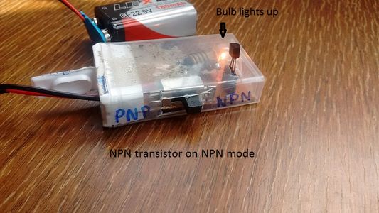

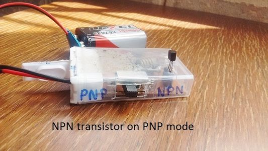

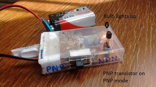

Now test the circuit. Put a NPN transistor through the stack headers and set the switch to NPN mode (The side of the switch which pulls the transistor's base to VCC). If the bulb glows the circuit probably works. Now put a PNP transistor and set the switch to PNP mode (the side of the switch that pulls the transistor's base to GND). If the bulb glows then your circuit works.Please refer to the images given above.
