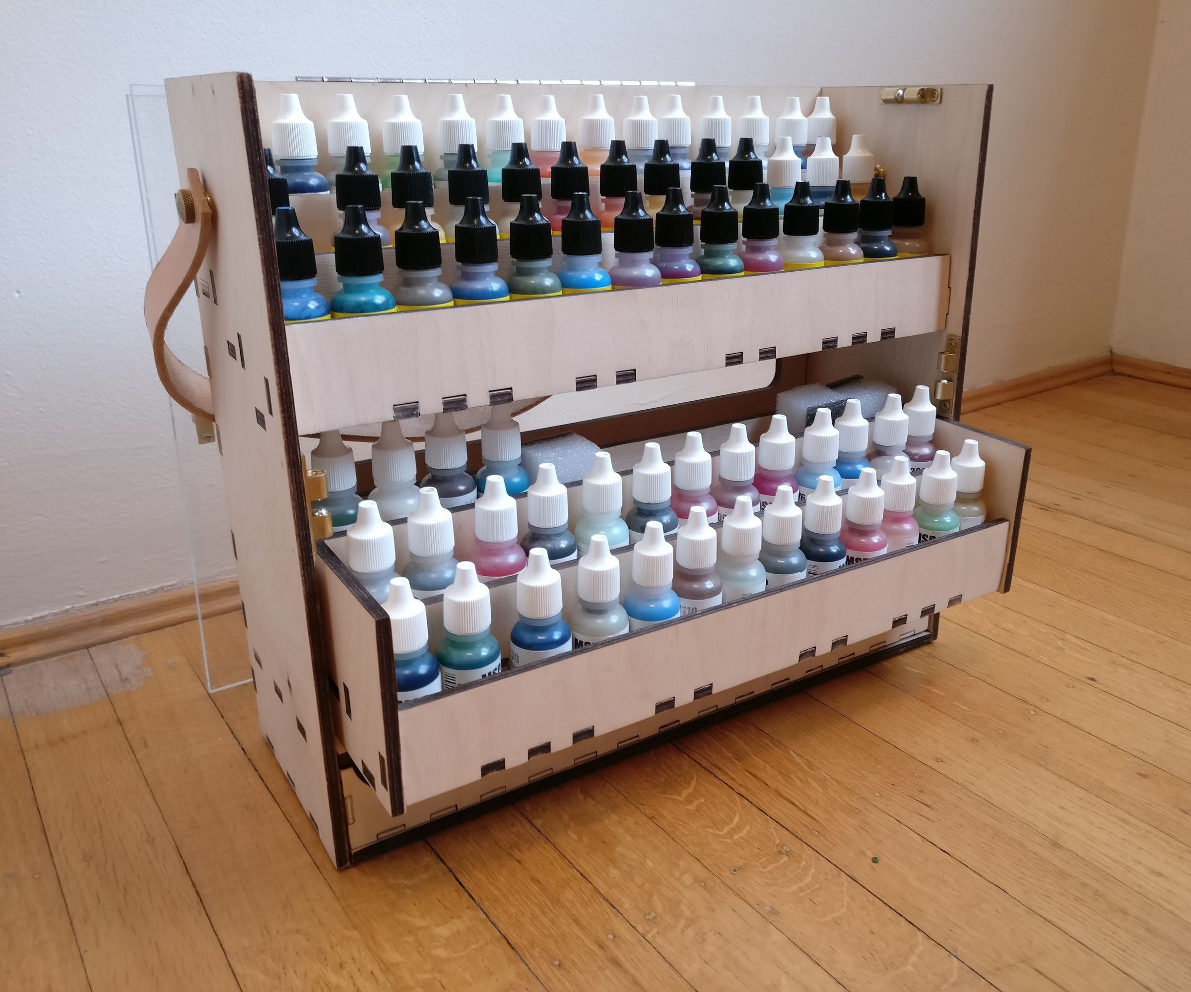

The case is made of a back box (which will hold the monitor, RPi, USB hub and some other electronics), and two front doors connected with piano hinges. There is a simple drawer (no slides) in the bottom of the back box that will hold the keyboard, mouse, and some of the larger tools that are too large to store in the doors. Each door is held on with piano hinges that allow them to swing all the way open. Stacking boxes will fit inside the doors, and will hold tools and various components. The boxes are held in place with elastic chord that runs in the slots from the top to the bottom.
I've designed several different storage boxes for you to pick from ,depending on what you want to store. Since each door is 400mm tall, all boxes are (slightly less then) multiples of 50mm. For example, there's a 50mm simple box for small components, a 100mm box to store my resistors in the glitter tubes. A 150mm box and a 200mm box for taller tools. Use each of these components in any configuration you like, as long as they add up to 400mm. Elastics hold the boxes in place.
The case itself is made from 1/4" ply. The drawer in the bottom made from 1/8" ply. The storage boxes can be made from either 3mm acrylic or 1/8" ply. I used acrylic in this Instructable so I can easily see into each box without having to remove it. The lids are held on with elastics.
The Triptich is carried by a harness that quickly attaches on the underside and around the doors and it's carried messenger bag style. I thought this would be a nice detail while removing any single points of failure that you might get from a single handle.
I've uploaded a sketchup 2013 file, as well as a 3D PDF (that, for some reason, has wonky textures) if you want to take a look.
