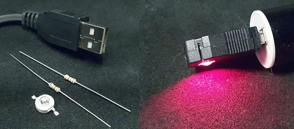

Let's start with the materials. One Plugbulb requires:
- A USB plug (preferably from a broken cable)
- A 3W LED bulb
- An LED heat sink
- 2 diodes, of the non light-emitting variety (any sort should do) OR a 5ohm, 1/2W resistor
- your favorite plastic bottle cap (here's mine)
- 1/2 packet of Sugru (or similar)
- a tiny, itty-bitty amount of thermal compound

Place a dab of thermal compound onto the center of your heat sink, then press your LED onto it. It will help hold the LED in place while you solder it to the heat sink. Now do that. Solder the LED to the heat sink.
Next, solder the LED and the two diodes (or your 5ohm resistor) in series. Remember, diodes are polarized, so make sure they are all facing the same direction, or your light will not turn on. Diodes usually have a silver band indicating the low voltage side. Make sure they each go into the circuit with this band on the side further from your 5V source. The LED is also a diode, meaning it is also directional. Make sure you have this pointing in the right direction too. Usually they have a marking on the tiny leads. If your's don't, use a low voltage source (~2-3V, two AA batteries in series will work) to test. You will not damage the LED by connecting it backwards, it just wont work.
I added some electrical tape to the back of the heat sink, then tucked the diodes behind it. It does not matter which order these components go in within the circuit, as long as they all face the correct direction.
