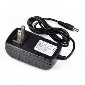

As you know that most adapters give more than 12v after being written 12v on it..
So we thought that more than 6v would damage leds
So we connected a 100k pot to the group of leds in series..
And then we supplied them power..
Then we conclude that we need to give them resistance between 50-57K ohm...

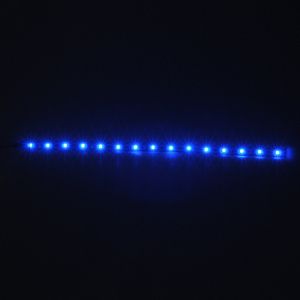

A 30 cm blue led strip
Buy

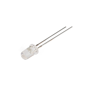

4 RGB Cyclic Flashing LEDs
Buy
A 12 v Adapter(With both male and female jacks)
Buy

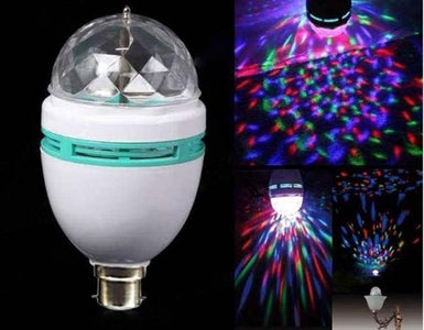

A party bulb
Buy

And take the party bulb.Open the Party Bulb by opening it's top screw and desolder the fitted LEDs. You can use these LEDs in this awesome torch. Now take out the motor assembly and the ac to dc transforming circuit. You can use this motor in this awesome Phone charger made by our school friend.
Now we just need the plastic casing and the reflector.
Now join the glass rod with the Led strip in it to the reflector with hot glue.Seal it's other side also (See images).
Note-Don't forget to take out the wires of the led strip from the screw hole at the top of the reflector.

On the perfboard fit the TIP31 and solder it.Then connect its left end to the left or right channel from the auxiliary / 3.5mm audio cable.You may need to use Leatherman tool for cutting the Auxiliary cable to put out it's wire which are the left and the right channel wires and the ground wire.Connect the middle end of the transistor to the negative of the Led strip. And then connect the right end of the transistor to the ground from the auxiliary cable. Now solder the connections and join extra wires at the Positive of the Led strip and also at the right end of the transistor.
These are the positive and negative of the circuit respectively which are to be connected to the adapter, later on. Now leave it aside.

Now take two RGB Leds and connect them in series that means the negative of one Led is connected to the positive of the other.
Now keep them aside and follow the above steps for two more RGB Leds. Then solder both the circuit of RGB Leds parallely that means that positive of one series is connected to the positive of the other series and vice-versa.
Now join extra wires to both the solderings where you have connected them parallely. Now these are the positive and the negative of the circuit and each Led will get 6v as discussed earlier in the Calculations step.

Now connect the circuit to the splitter and the female adapter port to the body. Now insert the RGB LEDs in the center of the plastic casing of the party bulb.
Now join the reflector with the glass rod to the plastic body/casing of the party bulb with hot glue.
