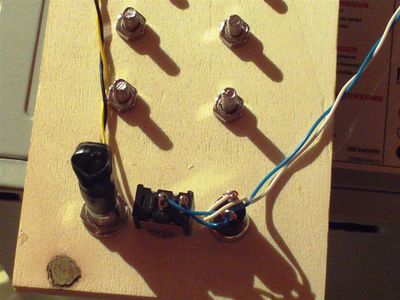

Step 2: Mount Binding Posts
I Mounted 7 Pairs of binding posts on the front panel.
The horizontal spacing is 3/4" and the vertical spacing is 1".
I drilled my holes slightly small so that I could screw the posts in tightly.
I added the LED & the switches off to the side of the panel.

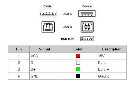

Step 3: Add the USB Ports
The pair of USB ports are soldered on a small piece of strip board.
They are mounted to the top panel. The holes were drilled out then cut to fit with an exacto knife.
The jacks are connected to the 5v standby line so they always have power even when the main power supply is off.
Pin 1 on the USB port is +5v and pin 4 is ground.
Make sure that the USB ports are wired correctly
The voltage on the usb ports must be between 4.75 & 5.25 volts

The toggle switch is SPST and the pushbutton switch is a NC momentary. They are wired in series; one side goes to ground the other to the green power line.
