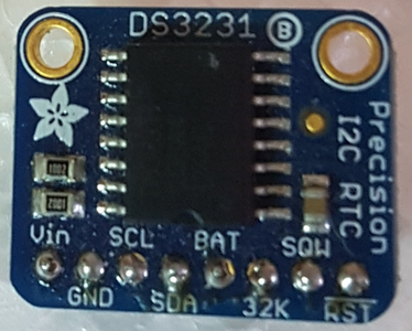

Real Time Clock
This board provides a connector for an optional Adafruit DS3231 real time clock (RTC) (feature I). If you don’t need it, leave it out (but figure out how you want to automatically turn the LCD back off). The DS3231 is very accurate but this module is rather expensive. Maybe in the future I will provide an option for a cheaper DS1307 instead since we can easily incorporate a WiFi module and synch the clock over the internet easily.

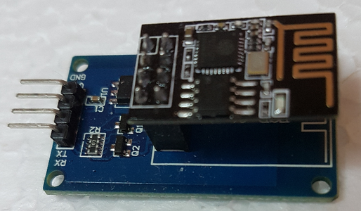

WiFi
It used to be a real pain to include an ESP-01 (or other) module because they require 3.3V and do not tolerate 5V (not even on the RX!). However, I found these nifty adapters that handle all the 3.3V and level shifting. These adapters are then simply connected to RX, TX, 5V and Gnd. This board is designed to keep the standard serial available (feature S) to the FTDI (for reflashing, downloading log data, etc.) so I recommend attaching the WiFi to RX1, TX1, 5V and Gnd which are conveniently located right next to each other on the expansion port (feature X). Of course, the WiFi is optional, leave it out if you so choose. (But I encourage you to think about the possibilities of having it!) You could also power it from VPer instead of 5V so that it is also under programmatic power control.
