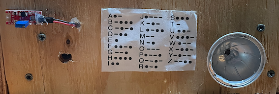

  • Various electronic sensors. I used the following types of sensors: sound, light, tilt, touch, and magnetic.
  • Various output devices. I used an LCD screen, RGB LED's, a buzzer, and a solenoid to make tapping sounds inside the box.

  1. Mark with pencil where you will make holes. This means any LED, button, or physical puzzle that needs to stick out of the box should be marked first. Don't forget components like buzzers, that may need holes even though the user will not interact with them.
  2. Make your holes. This means cutting if you're using cardboard, or drilling if you're using wood.
  3. Fit-check. Improve. Repeat. It's better to start with holes that are too small and make them bigger then the other way around
  4. Hot glue your components in place. A little bit goes a long way.

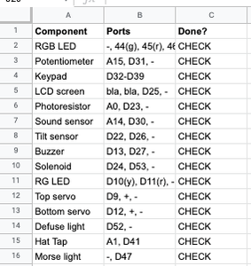

Step 5: Plan Before Wiring Gets Out of Hand
  1. Make a Google/Excel Sheet with all your components and what Arduino ports they will be connected to. This might seem overkill, but you will be grateful in the long run when you start to connect all of your components.
Step 6: Wiring
  • Wire your components to the Arduino in a logical order. Make sure you don't tangle wires too much, or they might pull on each other.
