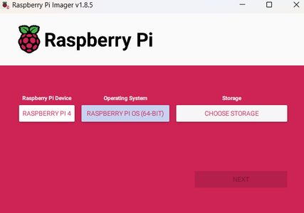

Step 1: Set Up the Pi
Download the Raspberry Pi Imager and open it. You will need to flash your Raspberry Pi with Raspberry Pi OS 64-bit. Put your microSD card in your computer then select it from the choose storage menu. Make sure to apply OS customization settings and edit them to include a password and your wifi network information. Click Next and then Write. Once it's done, put the microSD card in your raspberry pi.
