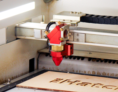

Step 1: Laser Cut Materials
First we will need to cut the physical housing for this is project
We will need:
3x 5.77x4in rectangles of clear acrylic (1/8th inch thickness)
2x 5.77 side length equilateral triangles of clear acrylic (1/8th inch thickness)
I was able to achieve this at the BC hatchery, so a big thank you to the for allowing the use of their equipment!
I designed them in Adobe Illustrator and there are built in tools for both.
Use the rectangle tool to make the 5.77x4in rectangles of clear acrylic.
Use the polygon tool set to 3 sides to make the 5.77 side length equilateral triangles with radius 6

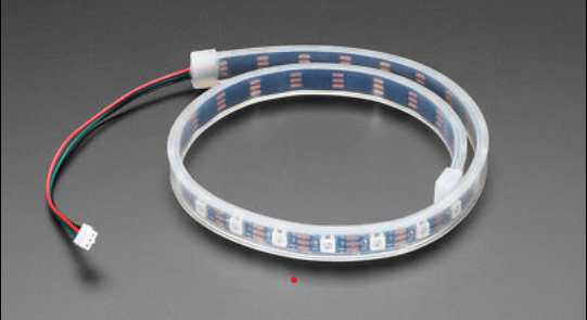

Step 2: Wiring the Pico to LEDS
I used 2 of the Neo Pixel strips (pictured above)
For both I took several steps to modify the neo pixels :
1) I cut the ends of the wires in order to make a more stable connections
2) I then stripped the last quarter inch of the wires
3) Following this, I soldered on one end of a male to male jumper cable to each of the wires
I then connected the 6 wires, the grounds for each, the 5v inputs for each, and the data for each to my PICO W mounted on a bread board.
In this step I personally used pins GP6 and GP8.
Know where you keep these, it is important as the GP input will begin to fill quite quickly.
We will be using these with the Adafruit_NeoPixel library in CircuitPython.

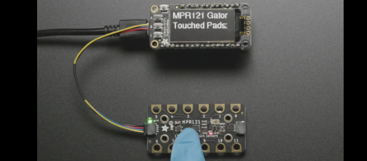

Step 3: Wiring the MPR121 to the Pico W
Here we wish to use the very helpful existing I2C pins.
Yellow goes to GP5
Blue to GP4
Red to 5V
Black Ground
Keep in mind there are specific libraries we will need to with, the Adafruit_MPR121 library is essential on the PICO W when doing this in CircuitPython.
Here I will only use pads 1,2,3,4, where I used alligator to alligator clip wires to connect these pads to capacitive touch tape that will functions as our buttons later.

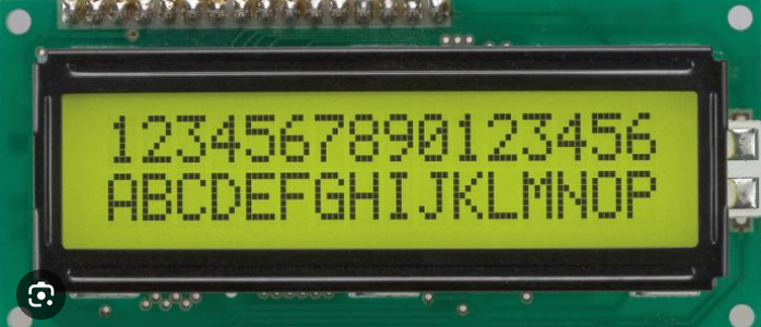

Step 4: Wiring on Our LCD Screen
Some LCD screens come with I2C compatibility, unfortunately mine did not and had lead to the wiring being slightly painful.
I HIGHLY HIGHLY recommend keeping the LCD on a bread board and having wires going breadboard to breadboard to communicate with the Pico, LCDs are temperamental in my experience
We need to connect 11 of the 16 pins from the LCD screen to the Pico.
Keep in mind, while "backlight" is mentioned in many guides, we will not be assigning it a pin here.
For a great general guide to wiring the LCD, please see the attached link, it was a life saver.
The pins on these board have names, but are also labeled 1-16 which is how I will be referencing theme here
1 on the LCD goes to ground
2 on the LCD goes to 5V out
3 on the LCD goes to middle of the potentiometer (I will wire the rest of this in the next step)
4 on the LCD goes to GP16
5 on the LCD goes to ground
6 on the LCD goes to GP17
11 on the LCD goes to GP18
12 on the LCD goes to GP19
13 on the LCD goes to GP20
14 on the LCD goes to GP21
15 on the LCD goes to 5V out
16 on the LCD goes to ground
Note you need not follow this exactly however I recommend it as it makes board real-estate very tight and in this version all the data pins on the Pico side are near each other!
