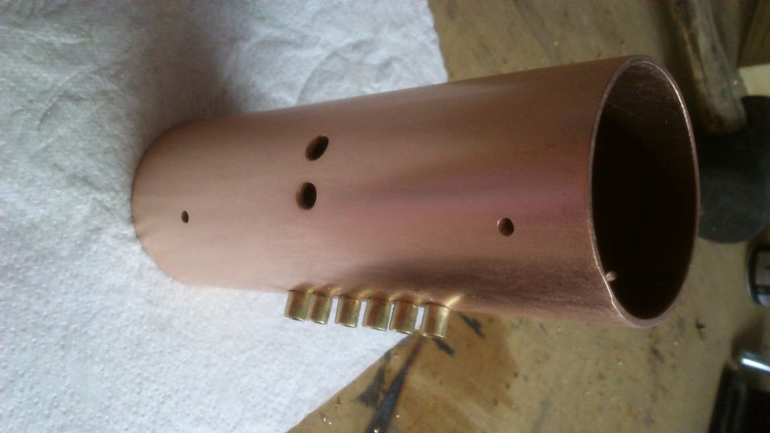

Now we take a Coppertube and drill holes where also the buttons are from the Musicman. I soldered smal Brasstubes as guidance for the Buttons. ( Second Pic ). I used old Lampholders for the Speakerhousing. Cut them and take ventilation screens from the building market. Stick it together. The Speakers from the Musicman fit in exactly (Pic 5 ). Put the Electronic inside the Coppertube, fix it with Hotglue. Now by the before drilled holes we push from above ball-screw inside as tracers. Now build everything together ( Pic 6 ) and you got an Mp3 Player in a Tube. Big Sry but I have no more other pictures !!!
