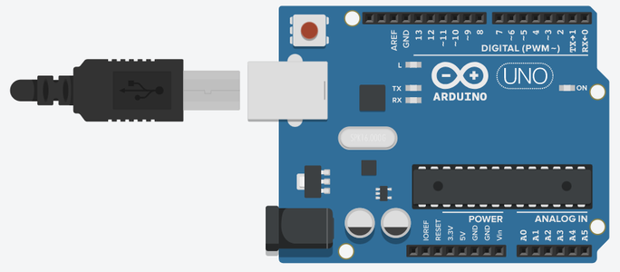

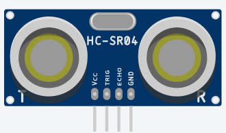

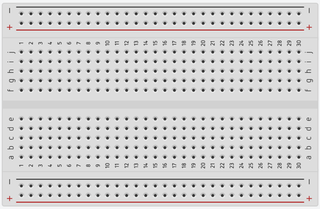

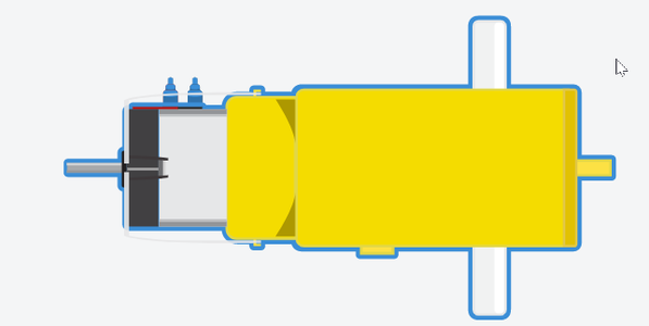

These are the supplies needed to build a obstacle avoider bot

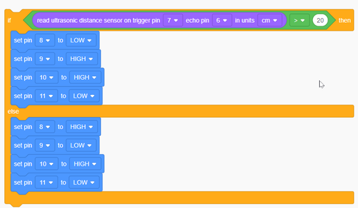

Step 2: Coding
This the block code if you want to use text, its in step 3
