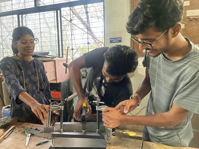

Begin by sliding the prepared modules into one another, as shown in the picture. As you continue inserting modules, you'll gradually form the circular shape of the wheel. Pay close attention to ensure that the modules are aligned and fit snugly together.
Step B-8.2: Insert fasteners
In the outer holes of the modules, insert M8 bolts (20mm length). Place M8 nuts on the opposite side and washers in between along with the bolts. Flip the wheel and insert the fasteners on the other side, too.
Important: Do not fully tighten the bolts and nuts at this stage. Leave them slightly loose to allow for adjustments.
Step B-8.3: Adjust for balance
With the modules in a rough position and the M8 bolts and nuts loosely in place, it's time for the fine adjustment process. This step is critical to achieve perfect balance and a smooth rotation. Arrange the modules such that the inner angle between adjacent modules is equal to 150 degrees (Calculation for other sizes: 180° - 360°/# modules = inner angle). The inner angle of each module, as indicated in the provided picture, plays a crucial role in positioning the modules. This step requires patience and precision to achieve a perfectly balanced and round wheel.
If you decide to use the provided side plate from the CAD design for this method, too, you can use it as a reference to balance your wheel and adjust it in a circular shape.
Fix the adjustment and angles with screw clamps.
Important: Do not tighten the outer bolts yet.
Step B-8.4: Mark the drilling positions
With the wheel assembled, balanced, and the outer screws tightened, it's time to proceed with drilling holes for the inner bolts.
Project the inner edges of the module that slides into the other on the outside surface. The objective is to create holes that align the two corresponding edges of adjacent modules, effectively fastening them together. This alignment contributes to the overall stability and integrity of the wheel.
Using a pen or a punch mark, mark the positions of the holes on both edges. Make these marks exactly 15 mm from each side of the created lines as shown in the picture.
Step B-8.5: Drill the holes with a 4 and 9mm drill bit
To ensure accurate drilling, use the 4mm drill bit from the previous step to create a pilot hole at the marked positions. This pilot hole will help guide the larger 9 mm drill bit and prevent any potential drifting during drilling.
Now, switch to the 9mm drill bit and carefully drill the holes at the marked positions. Make sure to maintain a steady hand and consistent pressure while drilling.
Step B-8.6: Repeat for all modules
Repeat the marking and drilling process for all 12 modules within the wheel. Each module should have corresponding holes that align with adjacent modules.
Consistency in hole placement and alignment is essential to maintain the balance and stability of the entire wheel and ease the assembly of the spokes to mount the wheel on the shaft in the following steps.
Step B-8.7: Remove C-Clamps and drill with 11 mm bit
Once the 9 mm holes have been drilled on one side of the wheel, remove the screw clamps. Move the modules one by one out of the balanced configuration and increase the borehole of the inner module with the 11 mm drill bit.
Step B-8.8: Insert rivet nuts
Immediately after increasing the hole diameter to 11mm, insert the rivet nut with the rivet nut gun on the inner module as shown in the picture. Apply constant pressure on all rivet nuts for better balance and fixation.
Step B-8.9: Realign modules and insert bolts
After the rivet nuts are all inserted, realign the modules into the balanced round arrangements. This time, you won’t need to measure the angle or use screw clamps since the 9 and 11mm boreholes will align perfectly. Once the modules are all aligned, insert the M8 bolts (30mm length) and washers.
Important: Don’t tighten the bolts just yet.
Step B-8.10: Flip and mark the drilling positions
Now that the wheel is perfectly round and one side has the fasteners loosely in place, carefully flip over the wheel and mark the drilling positions just like in Step B-8.4. Project the inner edges of the module that slides into the other on the outside surface. Remember to mark the drilling positions with a pen or punch mark exactly 15 mm from each side of the created lines as shown in the picture.
Step B-8.11: Drill the holes with 4 and 9mm bit
Follow the instructions of step B-8.5.
Step B-8.12: Remove inner bolts from opposite wheel size and drill with 11 mm bit
Once the 9 mm holes have been drilled on the second side of the wheel, remove the bolts from the inner bores of the first wheel side. Move the modules one by one out of the balanced configuration and increase the hole diameter of the inner module with the 11 mm drill bit.
Step B-8.13: Insert rivet nuts on the second wheel side
Step B-8.14: Realign modules and insert bolts
After the rivet nuts are all inserted on both sides, realign the modules into the balanced round arrangement. Again, you won’t need to measure the angle or use screw clamps since the 9 and 11mm boreholes will align perfectly. Once the modules are all aligned, insert the M8 bolts (30mm length) on both sides of the wheel.
Step B-8.15: Final tightening
Once you are satisfied with the fine adjustment and the wheel's balance, proceed to tighten all the M8 bolts and nuts. Tighten the bolts evenly and with consistent torque to maintain the balance achieved during the fine adjustment.

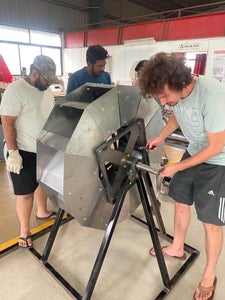

Step 9: Mounting the Wheel on a Shaft
Method A)
Now that you have successfully built the waterwheel and connected the side plates, it's time to mount the waterwheel to a shaft. Remember to use the parts and dimensions from the output of the dimensioning tool (see step 1.3). Follow these steps for a successful assembly:
Tools and materials:
  • Waterwheel
  • Flange (Hub)
  • There are two types of readymade parts that were found in Nepal and India to be usable as hubs: belt drive pulleys (cast iron) and chain sprockets (forged steel).
  • Belt drive pulleys have a good availability and lower price. However, the forged steel of the sprockets is a more solid and durable material than the rather brittle cast iron of the pulleys.
  • If chain sprockets and belt pulleys do not serve the specific purpose or are not available at your location, manufacture custom-made hubs out of brass or mild steel following the provided CAD files.
  • Shaft
  • Important: use solid shafts and not hollow ones due to the high torsion acting on it
  • Options in Nepal: 40mm readymade shaft out of C45 steel (includes holes for set screws) OR 60 and 80mm mild steel shaft (needs to be straightened with a hydraulic press, turned to 60 or 80mm on a lathe and fabricated with keyways and set screw holes)
  • Follow the dimensioning tool to choose the right diameter and length for your system. If you choose the materials described, you will retain a minimum safety factor of S ≥ 3. The shaft length from the dimensioning tool is based on a virtually perfect system, we recommend to add 10 to 20cm to your shaft length to provide margin for error and to couple the generator.
  • 2x UCP bearings
  • M10 set screw (40mm length)
  • M14 bolts (50mm length)
  • M14 nuts
  • M14 washers
  • 16-17mm wrench
  • 2x 22mm wrench
Step A-9.1: Connect flanges
Place the first flange on the inside of the waterwheel against the side plate and align the holes from both components. Insert the M14 bolts and nuts, placing washers in between and tighten them.
Place the second flange analogously on the other side plate. Take into account that the set screw or keyway position has to be parallel to the other flange (see picture provided)
Step A-9.2: Insert shaft
Insert the shaft into the waterwheel and align the holes or keyway from the shaft to the one from the flanges. Insert the M10 set screws and fasten them.
If you are using the provided CAD shaft design, be aware that one shaft model can be used for multiple wheel widths and therefore includes more drilling holes or keyways than you might need for your system. Pay attention to fix your waterwheel in the right position with respect to the shaft.
Step A-9.3: Connect bearings
Connect the UCP bearings on both sides to the shaft. Find the right position to fix the bearing taking into account the following two boundary conditions: first, you will need some shaft length outside of the waterwheel to connect your system to a generator; secondly, leave some space between bearing and waterwheel in case of wobbling or side movement of the wheel. You can use the CAD files as a guide for the position of the bearings.
Once you have found your desired position, fix the bearing to the shaft using the set screws and finally align the bottom plane of the bearings so that you can mount the system horizontally to the support structure described in the next step.
Your assembly should now look like in the picture provided.
