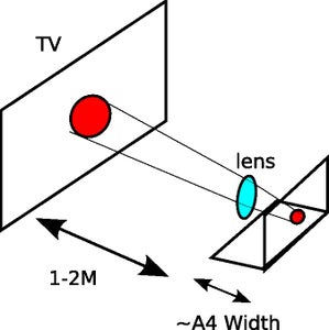

The most important bit about the lens is choosing one that focus an image from where you expect to stand to the scanner. It needs to project an image of something kept a distance of 1-2 meters in front of the lens, a distance of about the width of a piece of paper (210mm or 8.3in) behind the lens. The light coming in from the lens travels about the distance of half the width of A4 paper to get to the mirror, is reflected 90 degrees and then travels another half a paper distance to get to the scanner bed.
To find your focal distance find somewhere with a bright light source like a TV and grab your lens and a piece of paper. Dim the lights in your room and hold the lens in front of your tv the same distance you'd expect to be in front of your scanner when you would take the picture. Now move your piece of paper closer and further from the lens until your can produce a clear image on the paper. Get a friend to check if this distance is about the width of A4 paper. It can be a bit longer but not too long, else your lens barrel might be too long to be stable on the final WedgeCam

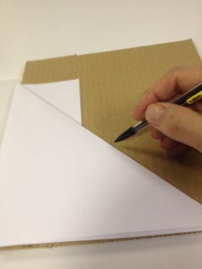

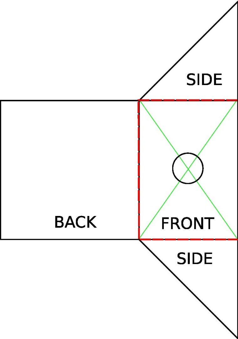

The shape of the WedgeCam is simple and can be made using the dimensions of an A4 piece of paper. The image above gives you an idea of the overall shape. Make each shape separately if you can’t make it on one piece of cardboard.
The front is the size a piece of A4 paper. The sloped back square piece has a lengths the same as the longest side of an A4 paper. The two sides are like an A4 paper creased as a right angle triangle. Mark a line on the front panel linking the opposite corners so you can find out where the middle is. You can use the paper and Mark around it to get the shapes.

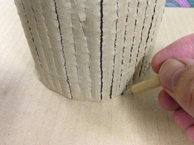

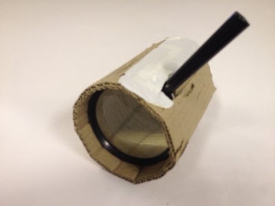

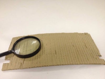

The lens barrel is a bit tricky, here we used a strip of card and creased it to make it bend around the lens easily. If you have a magnifying glass then it's handy to keep it for adjustment, in this case you can make a slot on one end of the strip for the handle.
The length of the strip must be a bit bigger that 3.14(pi) times the diameter of the lens. You can secure the lens in the new tube with tape. It's width would depend on your lens but 10cm should be enough.
With the new lens tube you can make a hole in the front card in the middle by drawing around it and cut it out.
Step 4: Assemble It!
You can tape all the panels you made together using tape along the edge. A thick dark tape is good to stop more of the light from leaking in. Fit the lens tube in the hole you made but don't tape as you may want to adjust this later.
