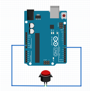

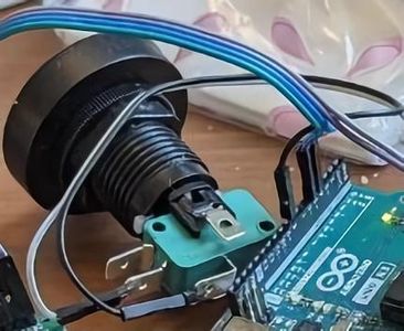

Step 1: Soldering Buttons
First I soldered some pin headers to two buttons so I could attach them easily to the Arduino using jumper wires.
I had to check first with a Multimeter to see which pins of the button made contact when it is being pressed so I could properly solder the pin headers and attach the wires. (I recommend using simpler buttons, but I liked the satisfying feel of these ones.)
After attaching them to the Arduino I moved on to the load cell.

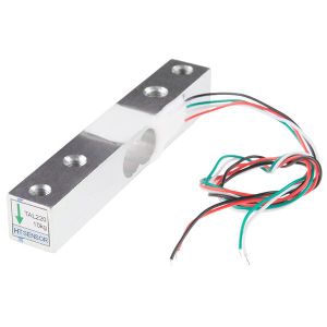

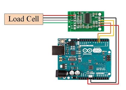

Step 2: Prepping the Load Cell
For the load cell I used a HX711 load cell amplifier as adviced on the store that I bought the load cell from.
The load cell worked different from what I expected. It works more as a balancing device in order to calculate weight than something like calculating it from pressure. (This becomes important later on!)
I soldered the wires from the Load cell directly to the Amplifier and attached pin headers on the other side to also be able to easily attach jumper wires from the Amplifier to the Arduino.
For some in-depth information I recommend checking out this instructable on the HX711 load cell amplifier: https://www.instructables.com/How-to-Interface-HX711-Balance-Module-With-Load-Ce/
Step 3: Setting Up Buttons in Arduino IDE
Now everything was set up and ready to be tested. I downloaded the Arduino IDE and attached the USB B cable to my computer.
To test the buttons I used a library made by a friend that was easy to use and helped a lot with sending the data to Unity.
To use this library just open a sketch in the Arduino IDE and drag and drop the library file attached below.

This will be enough to check if the buttons are pressed and return a 1 if they are pressed and a 0 if they are not. (Used for creating a boolean in Unity later!)
It's important to note that you NEED to do pinMode(_, INPUT_PULLUP) instead of output.
The reason why is that the Arduino puts resistance on top of where the electricity is going through so when you push the button the electricty goes to ground which is detected by the digital pin.

Before testing the load cell I thought it would be helpful (since large objects should be able to be weighted on the load cell) to attach a surface/support above it.
The load cell usally has a sticker showing which side should be down so it's important to check first before doing this.
I sawed a wooden plank in half and drilled two holes in them to attach them with bolts to the load cell.
This made for a helpful surface to place objects on and didn't impact the weight calculation at all since this can be accounted for during the calibration process.
Step 5: Calibrating Scale in Arduin IDE
Like I said earlier the load cell worked quite differently from what I thought and proved slighlty more difficult than I thought. The main issue is that the load cell doesn't know what 0 is and needs to be calibrated in order to weigh anything accurately on it.
Luckily calibrating the load cell is fairly simple, but will require another library that can be installed in the Arduino IDE.
For this go to Sketch > Include Library > Manage Libraries...
And from here type in: HX711
The first option should be the correct library to use.
The example sketch for the calibration can be found on this Github page: https://github.com/RobTillaart/HX711/tree/master/examples/HX_calibration
(I also recommend setting the baudrate in your sketch to a higher value since the load cell will give high values that otherwise can't be displayed in the serial monitor!)

Creating the controller taught me a lot about load cells and how they work.
My main challenge was figuring out how to attach the amplifier and calibrating the load cell properly, but it was definitely worth it for how accurately it calculates weight.
