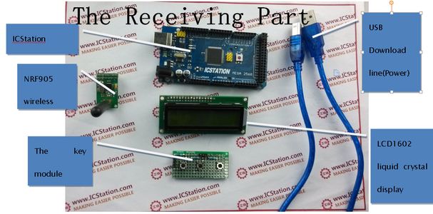

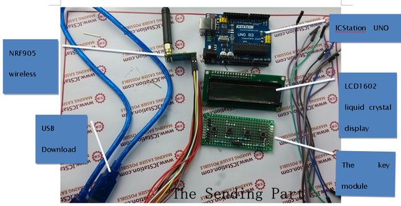

Step 1: Components List:

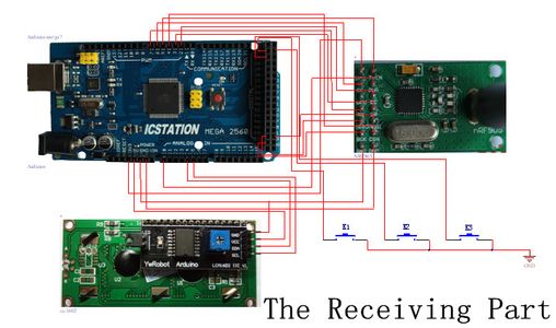

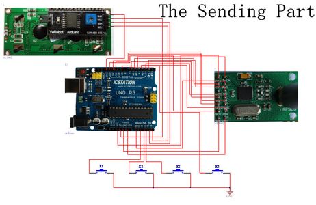

Step 2: Schematic Diagram
Step 3: The Hardware Connection of the Receiving Part
1.Connect the NRF905 to the ICStation Mega2560 as following:
TXEN—5; TRX_CE—6;PWR—A0;CSN—4;AM—7;DR—3;CD—2; MOSI—11;MISO—12;SCK—13 ;
2.Connect the LCD1602 to the ICStation Mega2560.
SCL—A5 ;SDA—A4
3.Connect the press key to the ICStation Mega2560.
K1—22; K1—23; K1—24
Step 4: The Hardware Connection of the Sending Part
1.Connect the NRF905 to the ICStation UNO.
TXEN=5; TRX_CE=6;PWR=A0;CSN=4;AM=7;DR=3;CD=2; MOSI=11;MISO=12;SCK=13 ;
2.Connect the LCD1602 to the ICStation UNO.
SCL—21 ;SDA—20
3.Connect the press key to the ICStation UNO.
K1—A1; K1—A2; K1—A3; K1—9;
