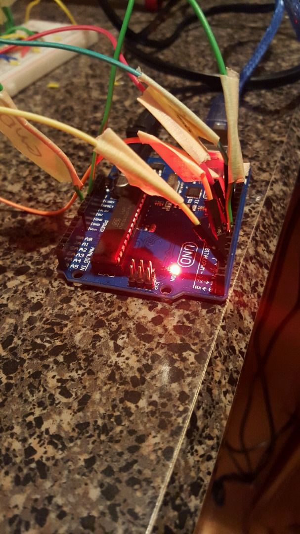

Hi,
I'm having trouble getting my word clock to work. Might the problem be that I have used ULN2003 drivers instead of ULN2003A drivers. I'm new with this stuff so I really have no clue what I'm doing wrong.
Thanks!
0
drj113
drj113
Reply 6 years ago
Hmm- that's odd - it should not worry about that.

Hi Doug,
I've been trying to debug this for a couple months now. I might be really silly about this but is it possible to get rid of the ATMega if just using an Arduino Uno? I'm just a college student and having my first run at electronics projects. Thanks so much for all the help
