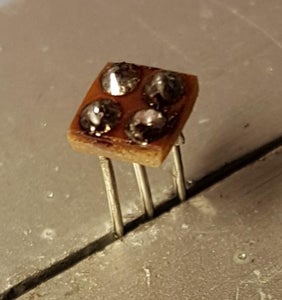

I didn't want to mess around with the (very nicely made) PCB. So I tried to produce a kind of adapter PCB from a leftover piece of prototyping board.
BTW, I don't remember having seen any design of a 2x2 proto board before (which is, in fact, a square of about 5x5mm).
And, in my opinion, this is the smallest sensible size for a proto board. Smaller ones, i.e. 2x1 or 1x1, with two solder pads or even only one, might be thought of. But these are neither particularly useful nor do they make any sense.

A single-sided prototyping board cutoff is sufficient if you use it with its solder pads ('donuts') pointing upwards. Fix three 'terminals' consisting of bare 0.6 mm wires in the corresponding holes. Before inserting them, bend their ends by 180° and flatten them slightly with a pair of flat-nose pliers, so that they fit snugly into the holes of the board without dropping out. In order for these terminals to match the footprint of the TO-92 device, the one in the top center must continue from the 'upper' pad to the one diagonally opposite, i.e. the 'lower' one (from north to south, as shown in red in fig. 1).
When soldering the terminals to the pads of the proto board, a little vice comes in quite handy - just clamp all three terminals. Don't use too much solder when doing this, otherwise positioning the chip might become difficult later.

While your assembly is still clamped in the vice, the SO-23 chip can be positioned and soldered. I admit that this is easier said than done, but I usually manage it at the 5th or 6th attempt...
It requires tweezers, a magnifying glass (preferably a watchmaker's magnifier) and a very fine soldering tip.
Sneezing or coughing while doing this is strongly advised against!
When you solder the chip, the tin with which the three terminal wires are connected to the solder pads melts again, and therefore it is quite convenient that the wires are somewhat fixed within the holes and with the help of the vice).
DO NOT heat the chip's tiny terminals for longer than two to three seconds to avoid damage! Take a short break after each solder joint, allowing the pins to cool down.
(The pictures above show the assembly before and after soldering the pins, and after placing and soldering the SO-23 chip).
