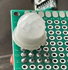

Step 2: Solder the PIR Sensor
Solder the PIR sensor onto the proto-board, with the pins in C13, D14, E13, and D12. Make sure to point the projection on the PIR sensor in the direction marked in the diagram. The PIR sensor should be on the side opposite the voltage regulator and ESP-01.

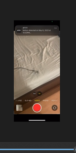

Now, when someone steps within the range of the sensor, you should receive a notification from IFTTT.

Now, connect the sensor unit to power (again, USE ONLY USB-A to USB-C CABLE). Wait for about 30s, and then move in front of the sensor. A notification will be sent to your phone. If the project works for you, please drop an I Made It! Thank you so much for checking out this project! Good luck!
