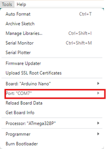

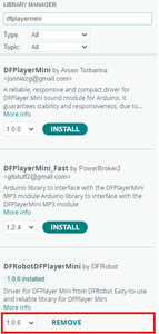

First, plug in your Arduino nano to your computer. Select the nano from the serial monitor and select the appropriate COM. In my case, it says COM7 but yours might be slightly different. Download the DFPlayerMini Library by going to Tools > Manage Libraries > Type "dfplayermini"> Install. (Mine says remove because I already have it installed).
Now download the following code and then upload it to your Arduino Nano. Once you click "Upload" There should be a message saying that the upload was successful. If you get an error, check that all your connections are correct and that you did in fact select the right board/COM.
