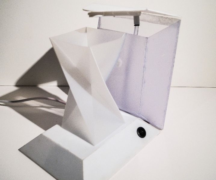

Step 8: The Palm Top Theater
Now that the zombie is finished, we will make the 3D palm top theater for in the mouth, where the kids can watch the catched monsters.
We start with cutting the beechwood plates in the right dimensions with the panel saw machine. The plates need tot be 3 x 400 x 600 mm to fit into the lasercut machine. The Adobe illustrator file with the drawing of the 4 parts are read in the computer and now the lasercutting can start ,as you see on photo 2.
The result are 4 parts that need to be glued together with wood glue.
The slots we made in the left and right side, are there to place in reflective translucent plates, so that the video on the phone will be reflected and create a 3D view of the video. We cut 3 little rectangles out of the PVC and slide them in the slots where the stars are placed. We made a lot more slots, so it would work with every phone placed in the palm top theater.
You can paint the whole thing (except the PVC rectangles) black, for extra effect.
The drawing of the parts can you find between the photos with all dimensions
If you wanna know how a palm top theater works, click on following link:
How a Palm Top Theater works
