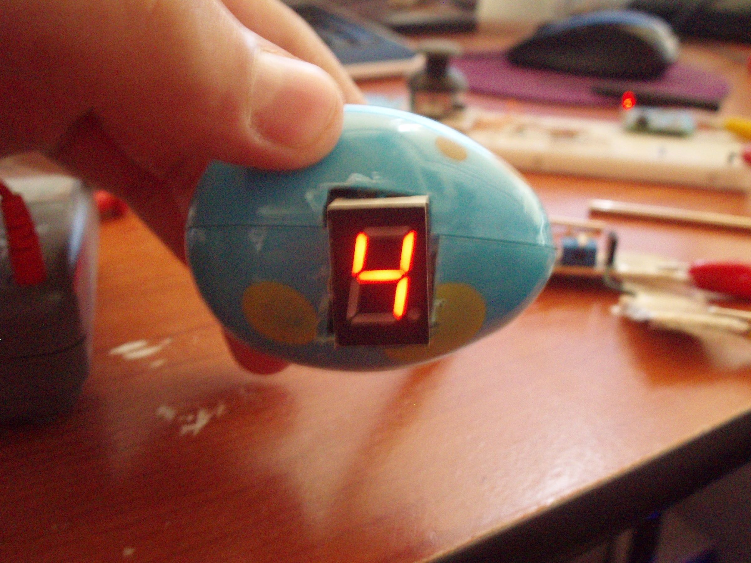

Hi everybody,
Today I'm posting my newest creation: The EGG-CLOCK!!!!
This little clock was made all by myself (lot of hard work :D), and the first thing you may notice is that it´s not too small, so i just
want to say that's the smallest thing I could create, if you still think its cool, you like it or you just don't dislike it THANK YOU A
LOT for you support!!!
Now, let's continue with the things you want to read: how it was made.
When I imagined it it looked really simple (the circuit itself is easy to do), but when I tried to put all that inside an egg, I faced some
problems so it ended being a 2-egg clock :|
Construction begins in step 1...

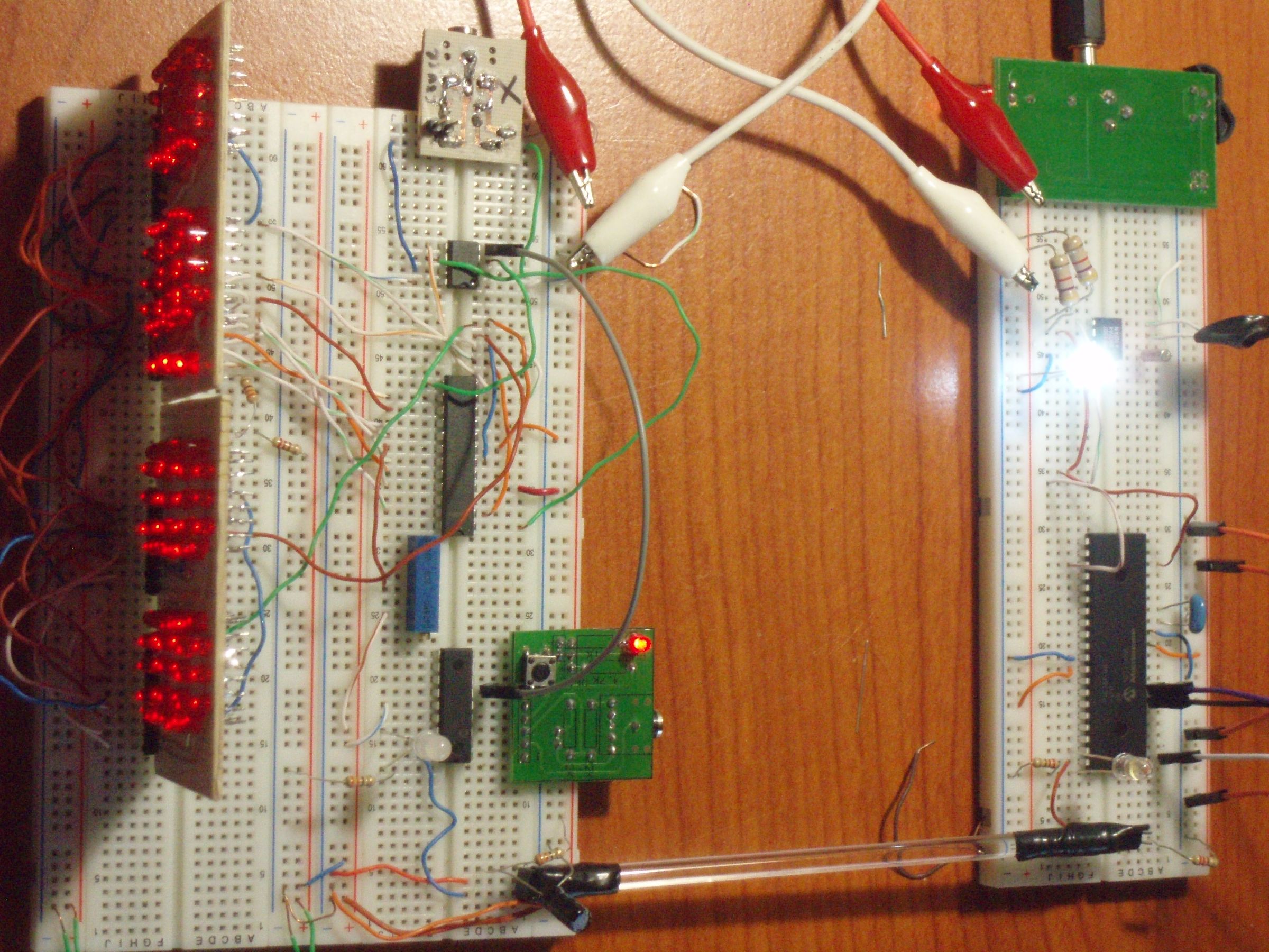

Step 1: Designing
Stp1:
The first step as you have read was designing, I took a whole day to do it, to make it fully functional. This step doesn't really have
too many things to explain, I used PCB wizard to make the design (pretty simple), I just place the components and draw ALL the tracks.
After some time I produced the complete design that consisted in:
1.- Seven segment display driver
|x1 Picaxe 18M2
|x1 7 segment display
|x1 Board
|x1 Potentiometer (Brightness controller)
2.- The Clock Driver ("Egg Driver" as seen on the photos)
|x1 Picaxe 20X2
|x1 DS1307 and it's resonator (Real time clock)
|x1 LED
|Many resistors
|x1 Board (it was difficult to make it like a circle)
3.- Power Supply & Programmer input
|x1 Board
|x2 3v Batteries
|x1 5v voltage regulator
|x1 Switch (to connect the MCUs to the programmer input)
|x1 3-pin female header (programming input)
So this was the first step...

Step 7: Completing the Clock
After all the hardware was made, came the software...
(I like those epic words I have just written)
Obviously the clock wasn't working by this point...
I was missing the code that would transform that junk pile* inside an egg, into the EGG-CLOCK (*sorry for using that term but seriously, without any programming that's what it is :)
( I can´t post the code in this precise moment, because I'm using different computers, but I will upload it as soon as I can [Probably a link in a comment])
Step 8: Is It Working?
After some corrections of the original code, the EGG-CLOCK was born.
It was working, finally!!!
Step 9: Conclusions
Almost all my goals were completed:
-I have created a clock that could fit inside an egg
-The clock was fully functional in all of it's specs.
-I could successfully finish another project (I'm very happy because I was able to make it very small)
But...
- Unfortunately I couldn't put everything inside just 1 egg (but, the objective was to put THE CLOCK inside an egg [the batteries are in the other egg:])
About the scroll: It actually works like this: blank-number-number-line-number-number-blank for example:
blank / 1 / 3 / - / 5 / 4 / blank = 13:54
About the cost: Its actually pretty cheap*, but it involves a lot of work (* less than $30)
