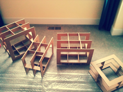

I used a another technique : “meshing”.This technique is the most used. We need 3 profiles (facade, intermediate and background). The intermediate one will be the skeleton, in which we will make notches that will take crosspieces. This method ensures the strength of the furniture.
So I did 4 squares with 3 profiles for each.

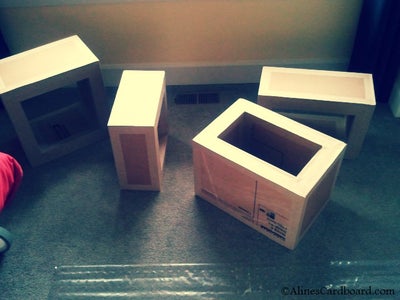

Next step, I covered my 4 squares and protected the edges with gummed tape

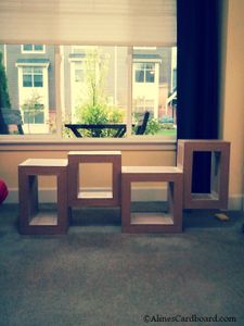

Then I chose a shape and I decided to put this bookshelf either upright or in horizontal way. I put the furniture up along the wall and then the floor ! I stuck the parts together with a glue gun and sealed them with gummed tape.

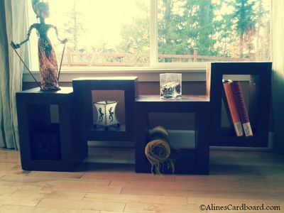

For the finishing stage, I waterproofed the whole furniture as usual and this time I coated it with a plaster and gave it a texture using a tape knife.
A very light sanding and it’s time to paint !
