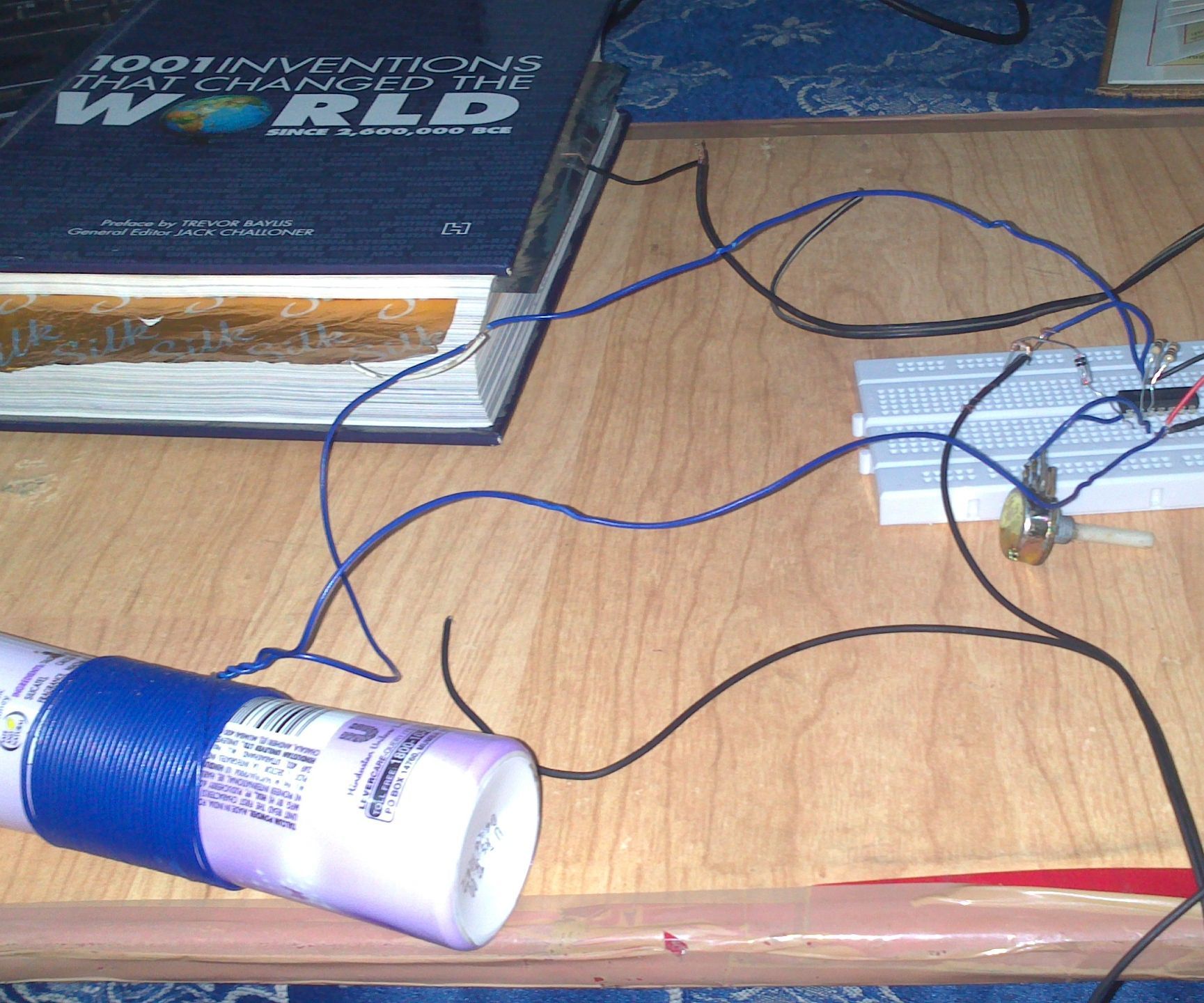

Step 2: Hardware Part
The Intel Edison board acts as the controller which decides based on the values of the temperature sensor to switch the cooling fan on or off. The cooling fan draws air from the top of the cap, cooling it, while it passes through the cooling layers, which actually consist of water soaked foam, with holes in the layers for air passage. The relay cuts of the current supply to the cap when the temperature of the temperature sensor goes below a certain value.
