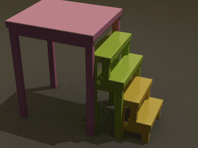

Since my last stool-step project reached a good popularity I decided to improve that design and make something totally new: a foldable table-step!
It was not easy making all fitting right but I reached a good design and as you can see from the animation it (should) work great!

Step 3: Open
When you open the steps you will find a very stable stair with 5 steps reaching 75 cm of height which is quite normal for a table. The steps are divided in two bodies and they have different width, so you have to pay attention to that when you descend from the top.
Step 4: Side Views
Each step has the same deepness of 15.5 cm, and they all are equally spaced from the outer side to the table edge.
The height of the steps is 15 cm, this is also not much and very handy to climb.
