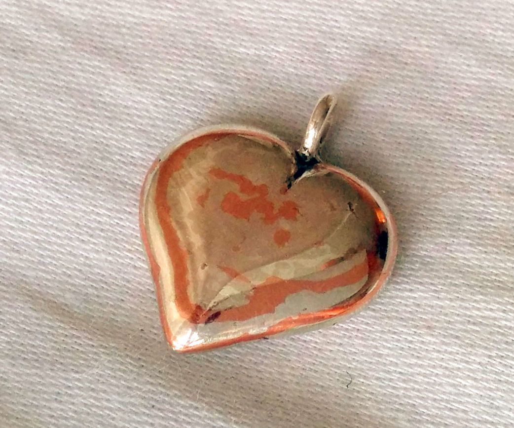

Introduction: The Illusionist Heart Locket
This is my approach at the illusionist heart locket, as a gift for my girlfriend. Many have already made attempts at this, and you can find some here on instructables, and even more on Google, but this one is made completely by me, i have designed and made every single piece of it myself. Because i used whatever tools i had at hand, some features might not be the optimal choice, so feel free to alter the specifications and features as you please.
I have seen some designs, that required very very tiny parts, that had to be extremely precisely made, but since i do not have access to neither laser cutters nor CNC machinery, i decided to make a simple design, that i would be able to make, without having to invest in additional tools or materials. I am pretty tight on my economy, so basically anything expensive was ruled out. I also set the criteria that the picture had to be centered, not on either half of the heart, which actually later lead to accidentally figuring out how to put 2 images in the locket.
Again because of my limited selection of tools, i decided to not make this a necklace pendant, but a 5*10 cm box instead. This was the only way so far that i could get the dimension relations as a wanted, and still have a decent size picture in the middle. It is still small, and has a nice size, fits nicely in the hand, and after several steps in finishing it up, it ended up having a bold and soft surface that i am very satisfied with.
I have uploaded this in the Valentine's Day contest, so if you like the project please vote for me :)

By now you should be left with an almost finished locket. To finish it off, I first cut the axle and sleeves down, and filed them down to sit flush to the surface. Then I sanded the outer corners, (only the outer!) with some 220 grit sandpaper. When I was satisfied with the shape, I polished it with 600 grit sandpaper, and gave the outer surface a final treatment of mineral spirits and linseed oil. It, apart from improving looks, also gives it a soft and comfortable feel, and I personally think it smells fantastic.
And that’s it! You’re done! All that’s left is to give it to whoever you made it for. I am thinking of making a nice box to put it in, but time might not be on my side.
