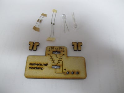

Step 1: What's in the Kit?
If you got a kit from the Bristol mini maker faire, here's what's inside.
Otherwise if you want to try an led moodlamp, here's an instructable that doesn't need a laser cutter!
Or, if you want to try a laser cut circuit board - the files are here. If your material is not 3mm, you'll need to use openscad to regenerate the dxf. Then you'll also need a couple of leds and some resistors.

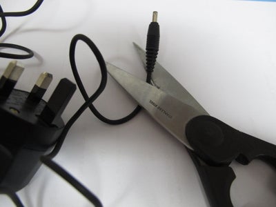

Step 3: The Fun Part!
use a pair of wire cutters (or scissors if you don't have any) to cut the end off the phone charger

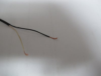

Step 4: Strip the Wires
we need about 5 cm of individual wires, so strip back the outer layer of the cable. Inside, there will probably be 2 wires of different colours. Here they are black and white. If you have more than 2 wires, don't worry.
Strip the ends of each of the wires inside, so there is about 1cm of bare wire. Twist the strands together to make them neat.

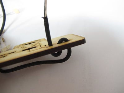

Step 5: Through the Holes...
thread the phone charger cable through the holes on the wooden circuit board. Then, if the cable is yanked, it won't break our circuit.

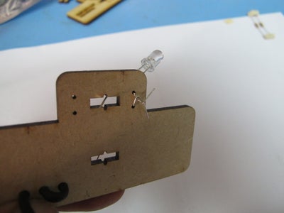

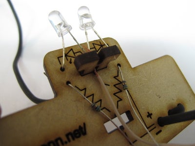

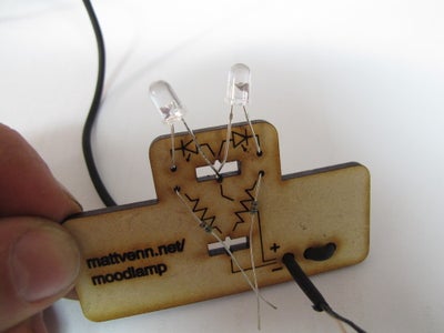

Step 7: Add an Led
Put the led's short leg (negative) in the small hole and it's longer (positive) leg in the big rectangular hole. Put the resistor in the hole shown.

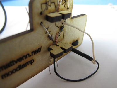

Step 8: Twisting the Wires
Turn the board over and twist together the wires

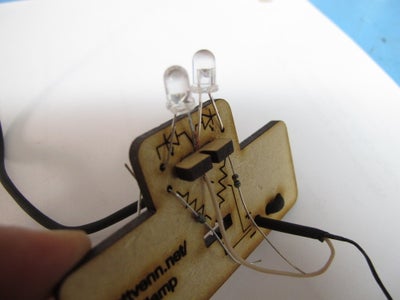

The wooden circuit board works by using a push fit plug to hold all these wires together. Make sure you get the positive wire (if you've forgot, you can always test first), then hold it and the led's legs in the middle of the plug hole.
Push the plug gently on top, and make sure all 3 wires still in place!

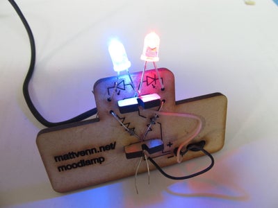

Step 13: Turn It On
Plug in the phone charger and both leds should light up! If not, then some of the wires must be the wrong way round. If you're careful you can get the plugs out by gently squeezing them from the back, but they're not really designed to be used twice. They might need gluing in place the second time.

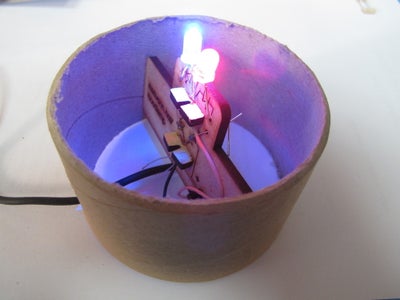

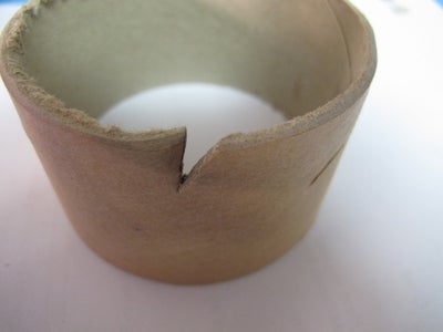

Step 14: Cut a Slot
cut a slot in the tape reel to let the cable out.
Step 15: And Push the Circuit Board Inside!
Now you're ready to add a shade. Tracing paper, felt pens, thin paper, hole punches, paint, whatever you fancy.
