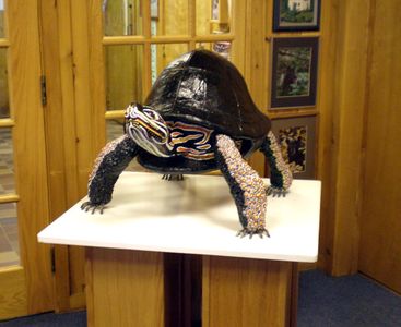

Maybe it was a bit too grandiose, but "Myrtle" was made to be a scale model for a much larger turtle intended for the entryway of a casino owned by the turtle clan, a.k.a. the Potawatomi Tribe, in Dowagiac, MI. The plan was that I would reproduce the turtle as shown ten feet tall, and then invite Native American artists from other tribes to use each section of the shell as an individual canvas upon which to depict what it means to that artist to be Native American. This, truly painted turtle, would be located near the entrance for tourists and locals to walk around to view a mosaic of meaningful art. I was never able to find the appropriate person with whom to discuss the concept.

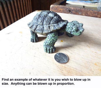

I purchased this turtle figurine from a Goodwill store for 25 cents. It was to become Myrtle, 36 inches long.
As the photo states, "anything can be blown up in proportion." I mentioned on a different Instructable titled, "Rhonda the Rhino," that I would show how I am able to go about determining proportions with confidence.
In an effort to explain proportion, my high school teacher pointed to two objects on the table and said, "It's simple. This is to this as that is to that." You're probably thinking of the same kind of expletive right now that I was thinking at the time. Once I figured out what the heck he was talking about, it has been a critical part of my art for the past forty five years.
The secret is a simple algebraic formula that you keep repeating over and over again until you have derived all the critical dimensions to make a scale model.

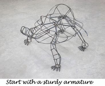

Step 4: Weld Up a Strong and Sturdy Armature.
After I used the small model to derive all the critical dimensions like length, height, and width of each of the parts, it was easy to see a turtle take shape as the wire rod was being formed and assembled. For the most part, I used 1/4" hot rolled steel to create the frame and 1/2" cold rolled steel to connect the appendages.
Once you see that you have the basic shape and proper proportion, you no longer need the model. This is when you start to add your own character. In the case of Myrtle, I didn't want just any kind of turtle, so I made her a mix of painted turtle, box turtle, sea turtle, and tortoise.

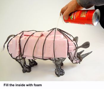

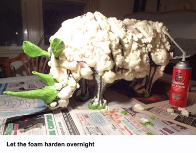

Step 5: Stuff the Inside With Pieces of Scrap Foam
Since I didn't have any good photos of the turtle in this foaming step, I borrowed a couple photos from my other instructable in this contest (Rhonda the Rhino) so that you can see the stuff I'm using.
What the foam scraps do is simply take up space so you don't use up so much expandable foam. Notice in the photo that I wrapped the legs of the turtle frame in cheesecloth. I realized later that I did not leave enough space between the gauze wraps to allow for the foam to expand completely. The gauze or cheesecloth should be very loosely wrapped with open spaces between the wraps. The foam needs room to expand, but still be contained to best extent. If the foam can't expand completely, it won't harden. The gauze helps to keep the foam restrained so you don't spill so much on the floor in the process. I even stretch wrap my shoes. It's really sticky, messy stuff to work with as it gets all billowy and pillowy. I highly recommend a full face shield, an apron, and surgical gloves when using moisture cured urethane foam. Cover the floor with sheet plastic. Moisture cured urethane foam sticks to just about everything except HDPE plastic.

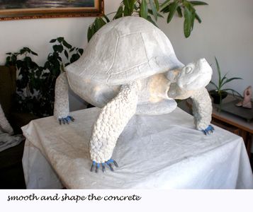

Step 7: Tricks With Green Concrete
A layer of steel mesh had to be applied to the legs first before the concrete was applied, but I decided to show the mesh process later so that I can present it in more detail along with the concrete process. You can see now why I elected to remove the carapace to be able to get to all of the legs.
Notice that Myrtle has a defiant stance and a slight smile. She's confident and friendly.
To make the scales on the legs, I thinned out some mortar to about the consistency of toothpaste and put some in a Ziploc bag. Then I squeezed all the concrete to one corner of the bag, snipped about 1/4" off the end, and used it like a cake decorator. Starting at the bottom, I squeezed an amount of mortar onto a fresh green base and worked the scales upward like putting shingles on a roof. It's best to work on only one appendage at a time and mix up only an amount you need to accomplish that part. The mortar will lose its plasticity if it sits too long.
Working green into green means that you apply a thin base layer of fresh concrete onto the foundation layer so the next layer will stick to it easily. It also ensures good contact. If the base layer dries out at all, it's difficult to get the new layer to stick. Work within an area that can be accomplished before the base layer starts to dry out. Misting lightly helps extend the working time.

Step 10: Apply the Concrete to the Shell and Carapace
I applied the mortar to the underside first by deeply and completely filling in all of the voids of the mesh, then flipped her over and did the same to the sides and shell working my way upwards.
Uniformly bulking up the concrete is my insurance against cracking due to errant impact later. There is a point in time as the concrete sets up to be a little like plastic where you can tap on the sculpture and move the cement around without causing cracks in the concrete. The outlines of the shell sections were not excised, but indented.
Before the concrete sets up completely, I burnished the surface of the shell and carapace with the back of a spoon. Burnishing closes the pores of the concrete to give it a smooth feel to the touch and a slight glisten.

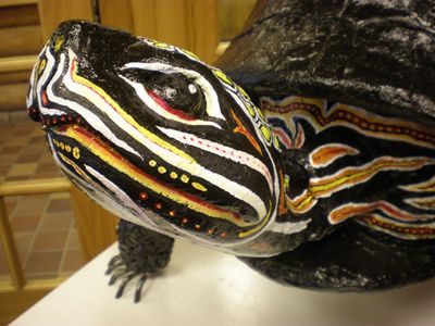

Step 12: Finish Paint

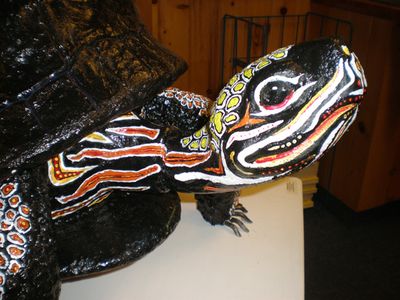

Two coats of a good quality black acrylic paint provided great contrast for the finish details that were not exactly intended.
I thought that keeping the lines not too different from those of a painted turtle would offer a basis for universal recognition. After that, the rest was ad libbed. At the time I made Myrtle, I had just learned about Oaxacan Art which are wildly colored caricatures of animals. It's actually quite refreshing to just go nuts with color and paint.
At first, I was a bit concerned that children might be afraid of Myrtle because of the way I painted her, but that was definitely not the case. Children were drawn to her like a kid magnet. For two years, I had Myrtle just inside the lobby door at the Marquette Tourist Welcome Center in Marquette, MI where I still work part time. I thought that I would have to repaint the head before the first summer was over from all the petting.
Many times I saw a mother with a kid or two in hand, walking fast on her way to the bathroom only to get jackknifed at the door when the kids all of a sudden dash into the lobby to get a closer view of Myrtle. The reaction to Myrtle still amazes me.

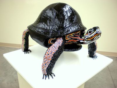

Step 13: Myrtle Finished
Mission Accomplished!
