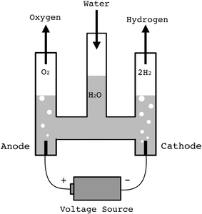

Step 3: DIY Hofmann Voltameter
What the heck is a hofmann voltameter?
Well, in order to not produce HHO gas we will need to produce the hydrogen and oxygen gas seperately from each other so they can't mix together again. This can be done expensively with a special membrane, or through the hofmann voltameter, which you can see in the picture. This constellation of the electrodes locally seperates anode and cathode so 'pure' gas is produced. Current flows through the electrolyte (in our case the 'water'), the gas rises up from the water and can be filled into a container of your choice.

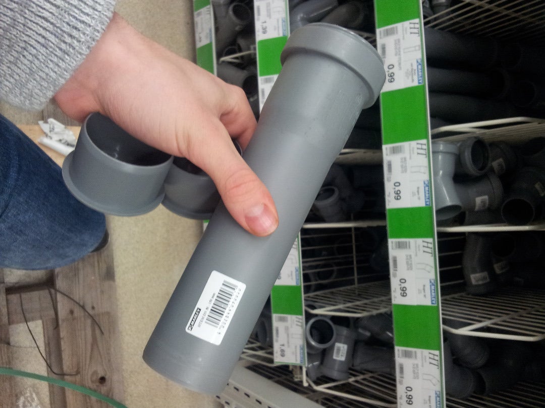

For obvious reasons you will need something to hold the water and the electrodes. As you can see in the picture a hofmann voltameter usually has three vents. Two for the gases, and one to fill in more water. We will skip the one for filling water, therefore our pipe will have a U-Shape.
The simplest way I found for building this was using Marley Pipes.
These are the PVC pipes used for indoor plumbing. They are practical for us as they already have rubber gaskets on them, which makes them air and watertight - and you can combine all different shapes and sizes to fit your needs.
For our version you will need :
  • two 90° angles
  • one short pipe adaptor (This one has gaskets on both sides, hence it has two 'female' ends)
  • two straight female-male pieces
  • two end caps
I got mine at my local hardware store for a little over 5€.
