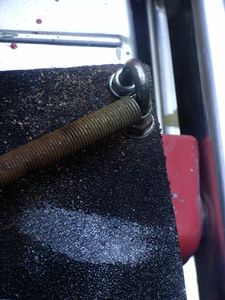

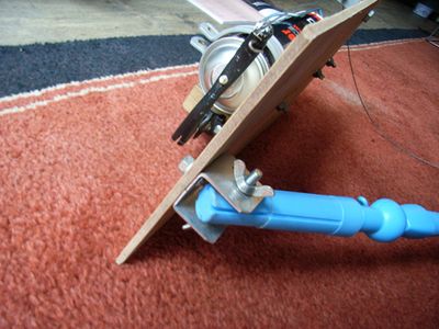

Start cutting the wood in the right size and drill the holes in the wood. I drilled four holes for the Bike water bottle holder and used wing nuts so it's possible to put 2 different sizes of spraycans in place. Then drill a hole in the end of the stick and make a hinge out of the alluminium strip, connect it to the stick with a wing nut so you can take it of and put a paint roller on to it.
Now connect the brake handle on the piece of massive wood. Drill 2 holes in the brake handle for the cable and for connecting the spring. If you finished all the parts you can put it on the right places of the plywood, mark the right places first.

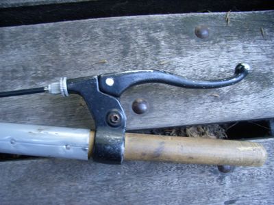

Connect the brake Handle at the beginning of the stick and connect the cable, lead the cable with the tieraps and tighten the cable correctly.

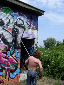

Now you can use it, so find those crazy spots and try it out!
Step 6: Result!
The result in pictures and movie!
