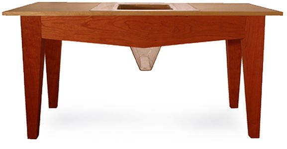

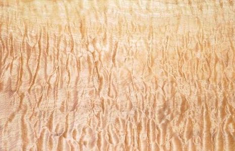

The overall table is 20inches wide by 36inches long and stands 20inches tall. The table top is made of Quilted Maple and the under carriage is made of fine Vermont Cherry. I must say the wood I bought for this was as good as you can buy. And I definitely paid a high price for it. I over bought in both types of wood because I wanted to have enough wood and possibly build two matching side tables. I bought a 12 foot long board of the maple that was 22inches wide and paid $112. The cherry was very costly (but the finest you can get). I bought 2 boards that were 10 foot long, 10inches wide and 2.5inches thick and paid about $360 or so, but the natural beauty of the wood shows.
Material List:
Quilted Maple - Quarter sawn
Vermont Cherry - fine (very few to no knots) - Quarter sawn

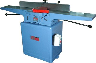

Step 4: Step 2: Dressing Your Rough Lumber
Then you will take all your pieces of rough lumber to the jointer. During the process of jointing the wood you must be very careful. Join each edge piece of lumber (the smallest side). You need the sides to be finished smooth to use the planar.
Once your sides are joined you can put your lumber lengthwise through a planar to dress the face of your boards. Once this is all done you have lumber which is dressed smooth on all sides and faces.

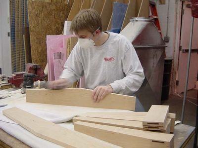

Cut your angles on your legs and the apron on the bandsaw. Mark all your cut lines on your pieces (measure twice and cut once). Then cut them out. On a bandsaw it helps to keep your eye about 1 inch in front of the blade on your cut line as you feed the piece through the blade. You will have a straighter cut this way; looking at the blade causes you to be reactionary and causes more errors, so keep your eye on the cut line.
Once your pieces are cut, sand them with rough sandpaper.

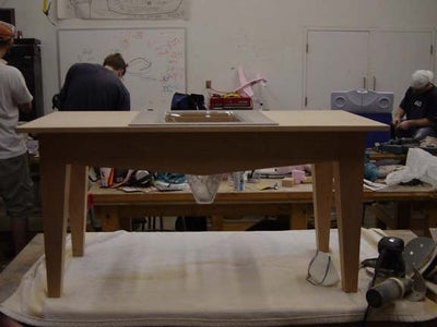

Now you have all your pieces for the undercarriage ready for a dry fit assembly. Take all your aprons, stringers and legs and assemble them to make sure everything lines up and is tight.

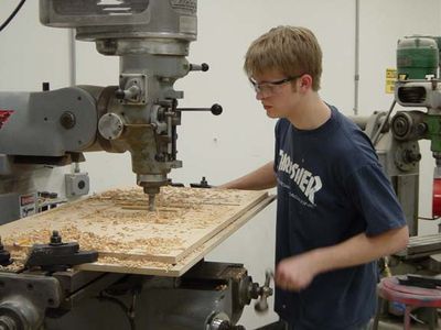

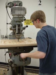

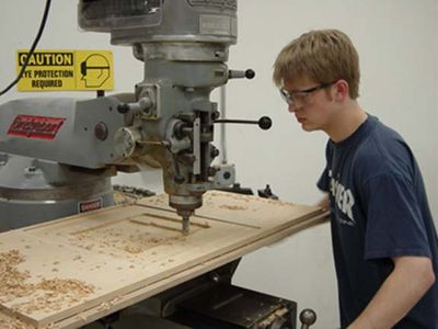

Step 10: Step 8: Router the Table Top

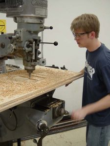

I used an unconventional way to router the top for this table... a milling machine. At the time I had more access to this than a router, so i used a wood bit in the machine, (no I don't own a milling machine this was the school's).
I double stick taped the table top on a piece of MDF and mounted it to the bed of the milling machine. Then I routered out the top in small increments to get the right depth of 3/8" for the plastic tray.

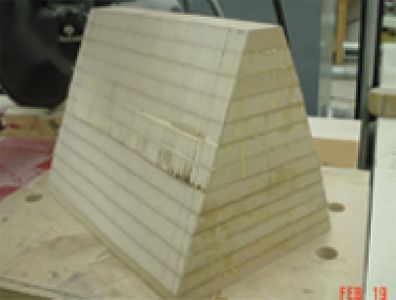

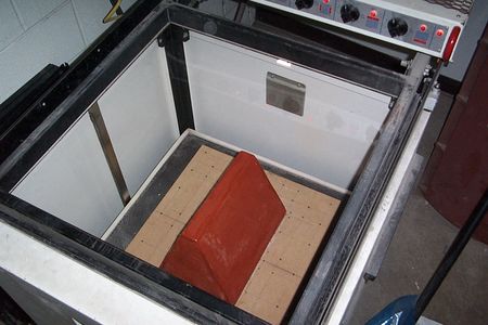

Step 11: Step 9: Build Mold for Tray

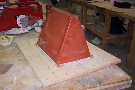

To build the mold for the tray I took MDF and cut them in increments to build a pyramid shape for the mold. I cut them on the band saw and then stair stepped the pieces. I glued up the pieces to create two halves of the mold (top and bottom).
I made two halves so it would be easier to cut on the band saw. Making this angled cut would be hard and dangerous (making a jig would be another option). Then I drew the profile pattern of the tray on the pieces. I cut out each piece on the bandsaw using this line.
Finally, glue these two pieces together, after set up you want to smooth the piece. Any imperfections will be seen in the plastic tray. I smoothed it with an orbital sander. Apply bondo, and sand smooth following the bondo instructions. Use different colors of bondo to help you see any imperfections or uneven areas. It takes time but is worth it to have a smooth part.
The triangular mold sits on a flat sheet of MDF. Drill small holes every 2 inches or so to allow the vacuum to suck down on the part. A 1/8" drill bit is good, too large of a hole will cause the plastic to create divits as the vacuum will pull it into the hole. The smaller bits allow for suction without imperfections in the plastic.

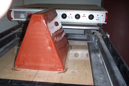

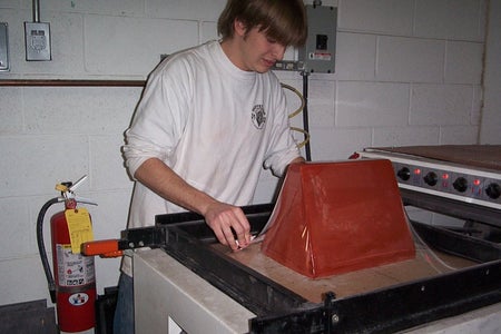

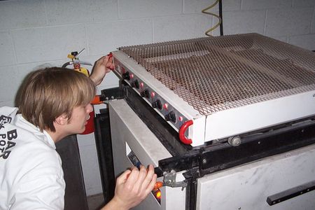

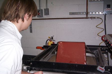

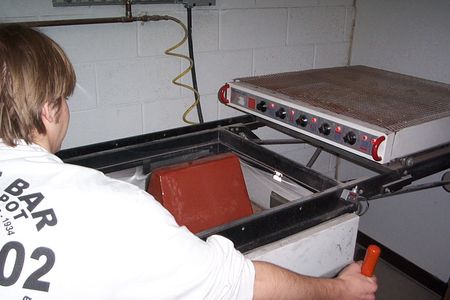

Step 12: Step 10: Vacuum Form Tray

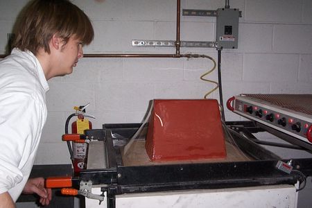

Prep your mold for forming. This mainly entails covering your mold with vasaline, yes vasaline. It creates a thin layer between the mold and plastic and allows the part to be removed from the mold easily.
Take the mold and place it in the vacuum former and lower the bed. Then you clamp the plastic sheet on the frame (spectar 1/4" thick sheet). Then you heat the plastic. It will take a a few minutes on high, but with this mold being so tall I needed to thoroughly heat it to allow it to properly stretch. Unclamp the plastic and flip it to expose the cooler bottom plastic. Then heat this side to get an even elasticity.
Once it heats, the plastic will drop about 10 to 12 inches, then it is ready to be vacuum formed for this mold. Remove the heaters and pull up the bed with the mold while turning on the vacuum at the same time.

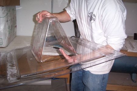

Step 13: Step 11: Make Final Cuts for Plastic Tray
Take the part and wipe it down. Take heavy masking tape or substitute and tape it on the bottom and top of the plastic sheet where you will be making your cuts. Build up a few layers of tape. Using the bandsaw on plastic will sometimes tend to shatter or crack the plastic so you have to be careful and gentle when cutting your plastic. The tape seems to help prevent less chipping or cracking. Mark your lines for the cut using a grease pencil on the tape.
Cut your piece out and sand your edges.
Note: if you have any shallow scratches on your plastic use a small torch to remove them, just quickly move your flame over them and they will disappear.

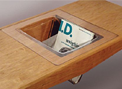

Step 17: Step 15: Insert Tray and Enjoy!
After the top is attached, simply place your tray in and a magazine. Enjoy.
