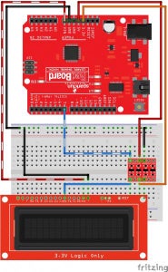

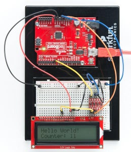

Step 1: Serial LCD Test
Hardware Connections:
Connect the RX pin on the LCD to the LV4 pin on the 3.3V->5.0V logic converter. Next, Connect the HV4 pin of the logic converter to the Arduino's TX Pin (Pin 1). Connect the GND on the Arduino to the ground pin of the LCD. Connect the 3.3V pin on the Arduino to the RAW pin on the LCD. Make sure that you are only inputting 3.3V into the LCD. 5.0V will short out the LCD. Next, connect the GND from the Arduino the Logic Converter. Connect the 5V from the Arduino to the HV of the Logic Converter and the 3.3V from the Arduino to the LV of the logic converter.
Coding:
*You will need to download the Serial LCD Library: http://librarymanager/All#SparkFun_SerLCD*
Download the code, then build and upload to your Arduino. Make sure to close out of the serial monitor while uploading your code, or the code will not upload properly. Run the code.

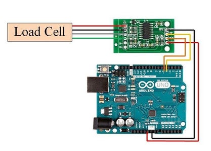

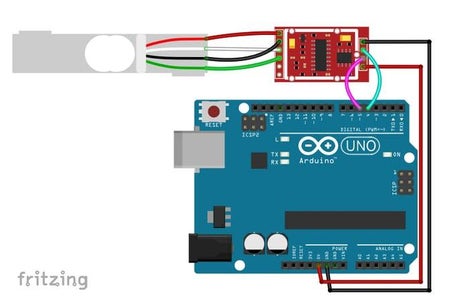

Step 2: Load-Cell Test
Connect the electrical hardware as instructed in the comment section of the code. Take any load off of the load-cell by placing the load-cell on a flat surface. Download the given code to your microcontroller. Open serial monitor and observe the printed data. Pull on both ends of the load-cell and observe that the number printed to the load-cell increases.

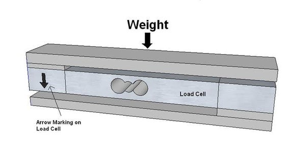

Step 3: Load-Cell Calibration
Hang the load sensor vertically with the load cell (white part) facing upwards. Download the load cell calibration software to your microcontroller, and connect to power. Connect the hardware as instructed in the comment section of the code. Attach a known mass to the end of the load cell.
I chose to use a can of Coca-Cola due to it having a known mass of ~382.91 grams.
Density of Coca-Cola = 1.042 g/mL
Can of Coke's volume = 355 mL.
355 mL of Coke = 369.91 grams.
Average can mass = 13 grams.
Can of Coke's mass = 13 grams + 369.91 grams = 382.91 grams.
You will need to calibrate your load cell by using the "a" and "z" keys on your keyboard until the displayed serial message matches the actual mass of the object. Take a note of the calibration factor.
/*  Hardware Connections:
 *   Load Cell Amplifier:
 *    -VCC -> 5V
 *    -GND -> GND
 *    -SCK -> Arduino Pin 5
 *    -DT -> Arduino Pin 6

Step 4: Load-Cell & LCD Combination
Connect the electrical hardware as instructed in the comment section of the code. Next, remove the load from the load-cell. Download the provided code to your microcontroller and connect power. Change the calibration factor to the factor that you got using the Load-Cell calibration program. The LCD should display 0 grams. Attach a mass to the load-cell, or simply pull on it - the data on the LCD should increase. Attach your known mass, and check for accuracy.
