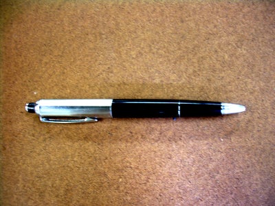

5) Electric Pen you may also find it at your local gag shop

Step 3: Take Apart the Pen
The pen unscrews at both the top and the bottom. Remove the battery and the bottom half is not needed. The top half is composed of a tube glued into the outer shell, you'll need to break this. Grab the inner tube with a pair of pliers, pull at one side till it cracks and then proceed to pull on the opposite side. It should crack again and slide right out.
The coils on the transformer are very thin, keep them safe, don't remove the tape that comes over them.
The coils work like a transformer with the high voltage coming out from the middle tab you see that would normally connect to the metal sleeve of the pen. The nub coming off the top of the transformer goes to the + of the battery and the thick wire goes to the - of the battery.
The idea is that the - side of the transformer will only be activated if the tilt sensor connects the central screw and one of the side bolts which would act as one continuous wire to the negative terminal of the battery.
