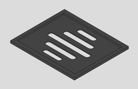

Select the 8 ohm speaker you want to use and take measurements for 3D printed parts for holding the speaker.
Step 11:
Design the speaker holder 3D print parts based on the speaker measurements. Design the cutouts for the top any way you like.

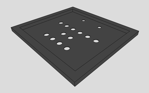

Design the clock holder 3D print parts based on the stock circuit board measurements and LED/button layout.

Isometric views of three of the 3D printed parts from previous steps.

Lay circuit boards from previous step into bottom clock holder. Take measurements for LED and button holes for the fourth and final 3D printed part, the clock holder top.
Step 17:
Isometric view of clock holder top.
