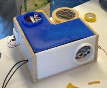

Step 1: Theremin Circuit
At first we assembled the theremin circuit by connecting an ultrasonic sensor to the music shield, which we then integrated with the Arduino. However, at this stage, we had not yet developed the program necessary to produce sound output from the device.
Step 2: Arduino's Code
Then, using the Arduino IDE and the Arduino programming language, we wrote the code necessary to enable the circuit to function as a theremin. Once the code was written, we compiled it to ensure there were no errors. Finally, we uploaded the compiled code to the Arduino board via USB. We've added a MIDI feature that allows you to alter the sound of the theremin, essentially giving you the ability to switch between different instrument sounds.
By following these steps, we aimed to create a fully operational theremin circuit using the Arduino platform.
The circuit seamlessly interacts with the program, responding to hand movements to produce a range of musical notes.
Step 3: Starting the Fuzz
We started to do the Fuzz circuit by welding the components following the instruction on the paper. We also did the Fuzz structure on "On Shape" to figure out how it could come up. Before printing it, we made the same one with foam.
Step 4: Theremin's Structure
We crafted the structure of the theremin using OnShape to ensure it is optimized for maximum functionality and practicality. Before deciding the ultimate version, we made another structure with wood to test it.
Step 5: Connect Fuzz & Theremin
At last we connected the Theremin with the fuzz. So now we can play the instrument without touching it and also distorce the sound we want to make.
