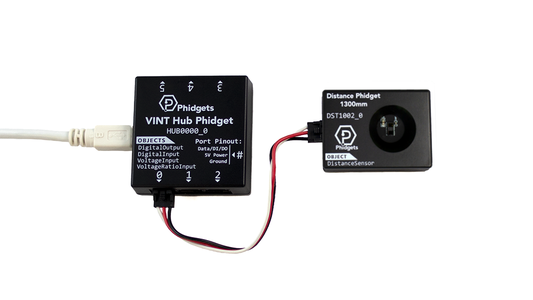

In this project, you will recreate this futuristic, non-contact effect using a Distance Phidget
  • VINT Hub
  • Distance Phidget
Step 1: Setup
Attach the Distance Phidget to your VINT Hub and your VINT Hub to your computer.
