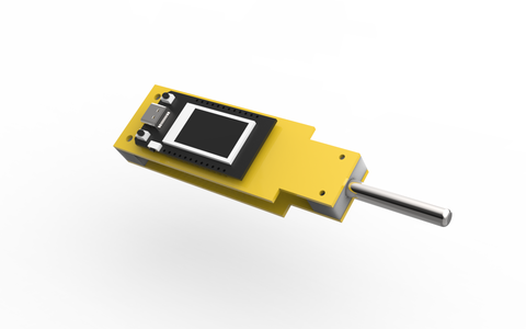

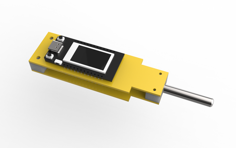

First, we model the TTGO board, the DS18B20 sensor, and the battery using Fusion360. Next, we position the temperature sensor on the front side and the TTGO board a little away from it. To connect both of them, we model a PCB.
A holder part with two screw mounts that fit into the PCB holds the temperature sensor in place. One PCB will be positioned on top, containing all of the components, and a second PCB will be placed in its place, empty.

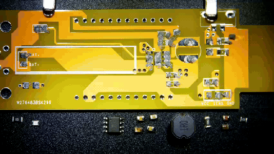

Step 3: PCB DESIGN
The first step in the PCB design process is creating the schematic, which shows the TTGO T-Display board connected to the DS18B20 temperature sensor by a CON3 header pin. We attach a resistor between the sensor pin and the CON3 header pin of the temperature sensor's VCC.
The DS18B20 digital thermometer provides 9-bit to 12-bit Celsius temperature measurements and has an alarm function with nonvolatile, user-programmable upper and lower trigger points.
The DS18B20 communicates over a 1-wire bus that, by definition, requires only one data line (and ground) for communication. This sensor pin is connected to GPIO2 of the TTGO T-Display Board.
This sensor comes in two forms: one that looks like a transistor and a probe-like device that we are using in this project.
Check out its datasheet for more information about the sensor itself.
https://datasheets.maximintegrated.com/en/ds/DS18B20.pdf
Our selected power source is the IP5306 IC, a well-known Li-ion power management IC that outputs a steady 5 volts from a 3.7-volt Li-ion cell and offers features like charging cutoff and battery fuel level indication.
We create the PCB outline and arrange everything in accordance with the layout by using the PCB design layout from the CAD design.

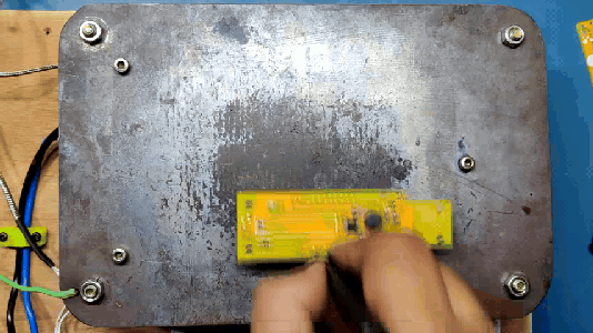

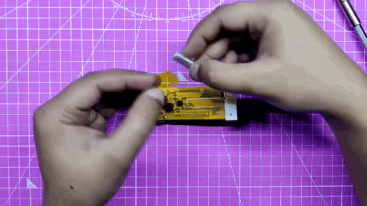

Step 4: PCB ASSEMBLY PROCESS

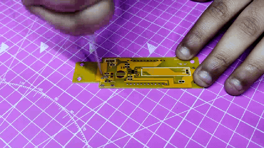

  1. Using a solder paste dispensing needle, we first add solder paste to each component pad individually to begin the PCB assembly process. In this instance, we are using standard 37/63 solder paste.

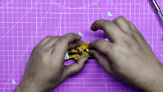

  2. Next, we pick and place all the SMD components in their places on the PCB using an ESD tweezer.
  3. With extreme caution, we lifted the complete circuit board and placed it on the SMT hotplate, which increases the PCB's temperature to the point at which the solder paste melts and all of the components are connected to their pads.

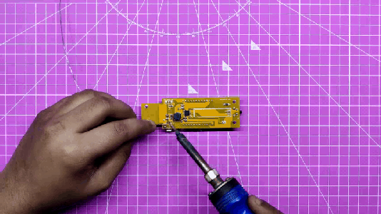

  4. Next, we add all the THT components, which include the header pin, horizontal switch, and USB micro port, to their locations and then solder their pads using a soldering iron.

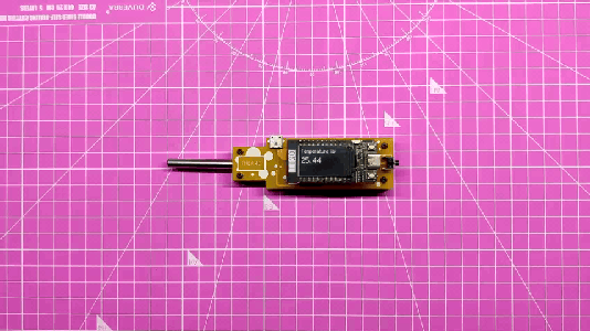

  5. At last, we added the TTGO T-Display board to its location through the header pins, and the PCB assembly is now complete.

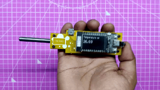

Step 5: MAIN ASSEMBLY

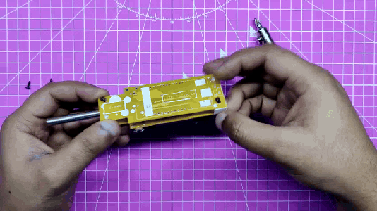

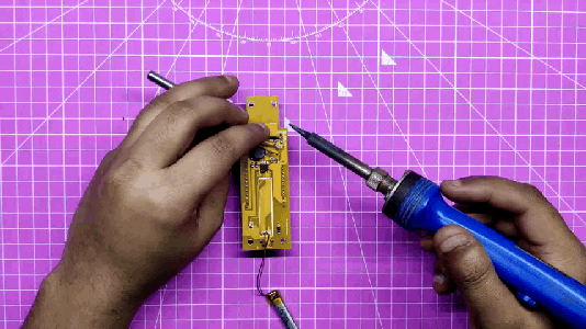

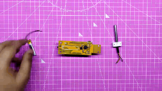

  1. The main assembly process starts by soldering the positive and negative LiPo cells to the circuit's battery terminals.
  2. Next, we attach the temperature sensor's wires to the pads provided on the sensor circuit.

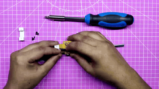

  3. The temperature sensor holder and the back holder with the TOP PCB are then fastened with M2 screws.

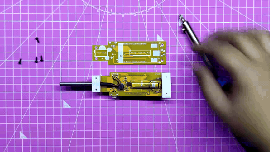

  4. To keep the LiPo cell in its place, we use Kapton tape to secure it to the back side of the TOP PCB.
  5. Next, we use an empty PCB, place it on the bottom side of the model, and secure it in place using four M2 screws.
  6. The thermometer is now complete; let's take a look at its code in the next step.

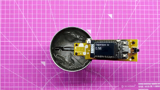

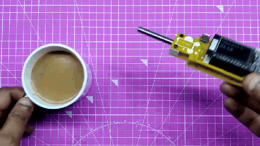

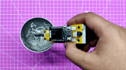

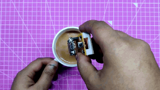

We first used a hot medium—a cup of tea—to test the thermometer. After dipping the DS18B20 Sensor's probe into the teacup and waiting a minute for readings, the temperature reached 64°C.
Next, we plunge the DS18B20 Sensor probe into a cup of ice and water, a cold medium, and allow it to take readings for a minute. This yields temperature readings of 0.56°C.

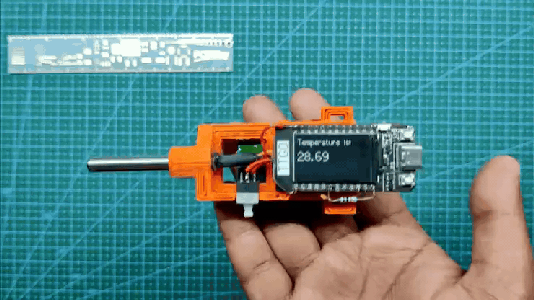

Step 8: CONCLUSION
Here is the end result of this straightforward build: a DIY thermometer that functions perfectly across all temperatures, hot or cold.
We saved a lot of space by employing a development board like the T-display board, which has an inbuilt display to make things compact.
