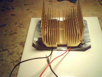

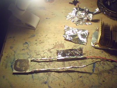

Step 2: Construction.
Pretty simple to construct the main housing and working device itself.
1:Firstly cut up your metal plate section get your x2 drinking cans and cut the top and bottom off them,then cut in half,do this with both pieces untill you have 4 thin sections of aluminium metal,grab your x acto blade or boxcutter,line up the 4 pieces and weight them down with something,now cut a cross x4 in four corners of the metal,once done use a pair of pliers or scissors carefully crimp the metal outwards,add 4 screws with 4 Bolts insert into the holes you had cut for the plate,and use pliers to bend remaining metal sharp bits downwards and around the bolts.....The base plate is done.
2:Thermal paste if available apply this now to the heatsink & base plate using an old credit card too spread the paste into a nice square the size of the peltier module,place the peltier module as so the cold side is where the heatsink will be and the side that makes heat on the bottom,check this by attaching x2 1.5v batterys and holding the peltier to feel which side is which,push lightly into the thermal paste,and lay the Heatsink ontop of the peltier lightly pushing into the paste once again,now the last part to set up the unit itself use pliers to bend thick copper metal around the heatsink and under the bolts on the baseplate,takes a bit of fiddly bending light metals into place around the bolts on both sides fixing the heatsink into a sandwich with the peltier module and baseplate.....Main Unit is done.
