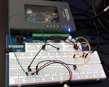

First, arrange the thermistor in series with a 10kΩ resistor and supply it with 5V. Feed the voltage across the thermistor to the MSP connector C - AI0 channel located on the right side of the myRIO.

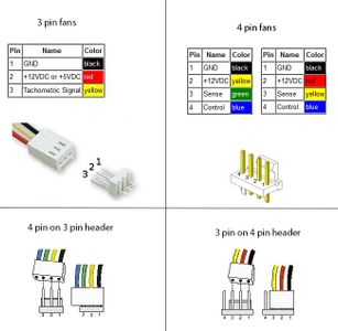

Connect MSP connector C - DIO3 (located on the right side of the myRIO) to the base lead of the transistor (this line is capable of pulse wave modulation). This channel will supply pulse waves to the transistor to switch the 12V connection to ground on and off. Next, connect the 12V external supply to the power wire of the fan and connect the ground wire of the fan to the collector lead of the transistor (refer to the pictures above to make sure the correct connections to the fan and transistor are made). Now connect the emitter lead of the transistor to ground. The transistor will now switch the circuit open and closed depending on the digital signal sent.

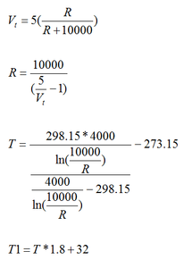

For the equations pictured above, Vt = voltage across thermistor, R = thermistor resistance, T = thermistor temperature in Celsius, and T1 = thermistor temperature in Fahrenheit. Vt is found using a voltage divider equation and R is found by rearranging this equation. Using R, the temperature can then be calculated. Note - in the Celsius calculation, temperature is calculated in Kelvin and then 273.15 is subtracted to give the correct reading. Also, the 4000 value used is the beta value of the thermistor found in the data sheet. These equations are used in the formula block in the block diagram.
