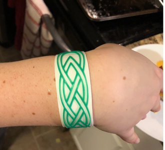

Step 1: Determine the Size/Shape
The first thing you need to do is determine how big you are going to make the bracelet. This constraint is partly based on the size of your 3D printer print bed. Your design cannot be bigger than your print bed dimensions as we are going to print these bracelets flat. For example the Makerbot build plate is 11.6 X 7.6 inches so the total bracelet design must fit within that area.
  • These bracelets examples are about 1 inch wide x 7 inches long. And about 0.1 inches thick. I kept the size relatively small because we had to print many of them in class.
  • For this example going forward we will use a 1 inch x 7 inch rectangular size limit.
  • You could make much wide bracelets but keep in mind it will use more material.
  • You can determine the approximate diameter of your bracelet based on the length of your design.
  • Length of the design = circumference of the bracelet
  • Diameter of the bracelet = Circumference / pi
  • For example if I design a 5 inch long flat bracelet I can determine that the diameter = 5 inches / pi = about 1.591 inches.
  • Keep in mind all of these bracelets will be "open-ended" so you could make a larger diameter bracelet with a gap at the ends as well.
Next you must determine the shape/style of bracelet you want to create. Each of these examples was printed with a solid background color piece. This was done to not only help with the contrast of colors but also to help the pattern maintain it's form later when thermoforming. You could also create a bracelet solely from the pattern design without a solid background, but it may be more difficult to thermoform consistently if the pattern lines are thin. It may require some experimenting on your part.
  • This is also dependent upon your printer. If you have a dual extruder or if you are able to pause and change filament mid-print, you can create these multi-colored layers.
  • If you do not have the ability to do this, you can still create a solid background just to make forming easier.
  • Single color designs could also consist of a pattern being debossed or cut into the solid layer.
The shape doesn't necessarily have to start off as a rectangle either. There are many possibilities that you could create.

Step 7: Thermoform Bracelet
The last step! (and most fun in my opinion).
Now it is time to turn the flat design into an actual bracelet.
Note: While PLA is generally considered safer than other filaments, I would still recommend doing this process in a well ventilated area. We are still talking about heating up plastic material so better to be overly cautious in my opinion.
  1. Boil enough water to fill the container you will use for this process
  2. Carefully place the bracelet into the hot water. Use tongs!
  3. How long the bracelet must remain in the water will depend on a number of factors like the thickness of the design, type of filament, etc.
  4. Anywhere from 10-15 seconds will probably make it pliable enough to form.
  5. Remove the bracelet from the water with tongs. Carefully shake of the excess hot water. Let it cool just enough so that you can handle it with your hands without hurting yourself
  6. Form the bracelet around a cylindrical object of the desired diameter. (You could 3d print a cylinder if you can't find an object that meets your requirements!)
  7. If you are going to form the bracelet around your own arm/wrist, make sure it is cool enough that it will not burn you. I don't recommend doing it this way as it will also be a less uniform circular shape.
  8. Once the bracelet is formed to your liking, run it under cold water for a few seconds until it maintains its form.
  9. You can reheat and reform the design as needed!
