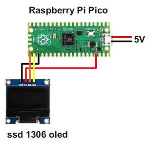

Step 1: Wiring
As far as the Rapberry Pi Pico has a built-in thermometer, only a display had to be added. It can be powered by a 5V solar panel too.
