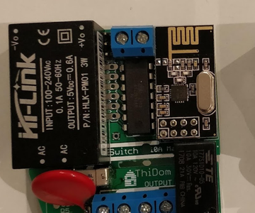

Step 10: Build a Node to Manage Relay
This node allow to manage a relay.
To build you need :
1 Regulator HLKPM01 ( 230V -> 5V)
1 Regulator TLV1117 (5V -> 3V)
2 Capacitores 1µf ( C1206C105J5RACTU ) One in input of TLV11171 and one in output of TLV11171
1 Attiny84
1 NRF24L01
1 Capacitor 4.7µF ( between 3V and GND of NRF24L01 ) ( C1206C475J3RACAUTO )
3 headers strip to temperature sensor
1 resistor 4,7 kohms ( CRG1206F4K7 )
1 relays ( T77S1D10-05 )
1 NPN to activare relays ( SST2222AT116 )
1 resistor 3.3 Kohms to NPN ( CRG1206F3k3 )
1 resistor 40 Mohms ( sensitif interrupt ) ( RH73H2A40MKTN )
1 fuse 800mA ( 0464.800DR )
1 varistor( V275LA20AP )
With this node you can manage thermostat, light and get temperature data
