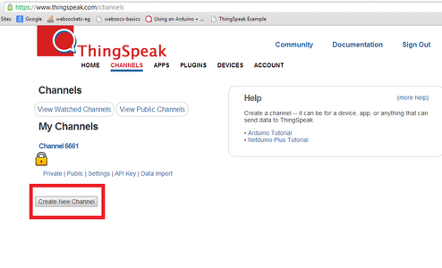

Step 4: Create a Channel for Your Data
Create a new channel by clicking on the “Create New Channel” button.
