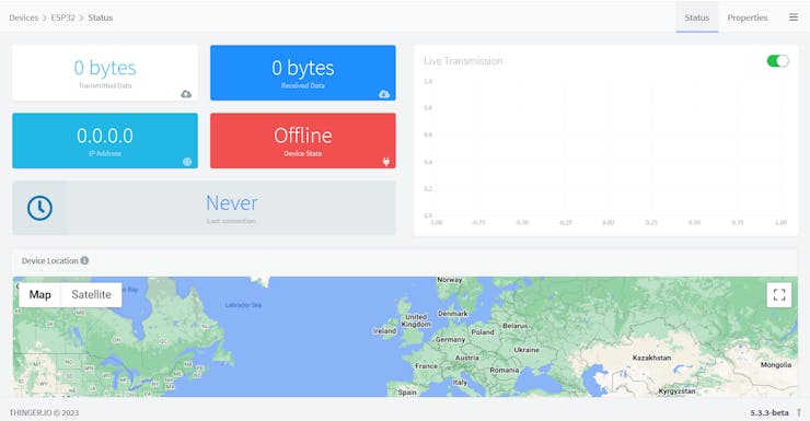

Step 5: Add a Device

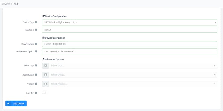

Once we log in, and the Statistics panel opens, we can head to the Devices section and click on Add a Device.
From there, provide the details -
- Device Type - Choice between IoTMP / HTTP / MQTT / NB-IoT. We chose HTTP to continue this article
- Device ID - We can keep any name, but preferably the device we are using, to be mentioned here - 'ESP32'
- Device Name - Keep anything, but we kept it as 'ESP32_SCHOOLOFIOT'
- Device Description - Mention in a single line its function use, like "ESP32 Device for Hackster.io"
- Once the Device is created, we'd be able to view the status tab of the device. It is the dashboard with device-specific details and provides insight on the condition of it.

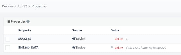

To create properties, visit Devices > Properties > Add Property.

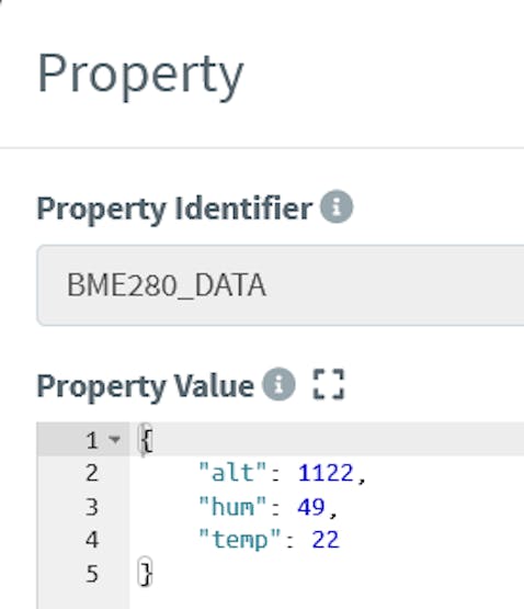

Once the identifier is entered, enter the property value in the form of JSON for payload data, and some other format (or even JSON) for response of data upon called.
I have created a device property to respond with 1 when request is successful.
Notice that the value of BME data is in JSON object format, this allows us to store and utilize the same device property to store multiple data with a single call.

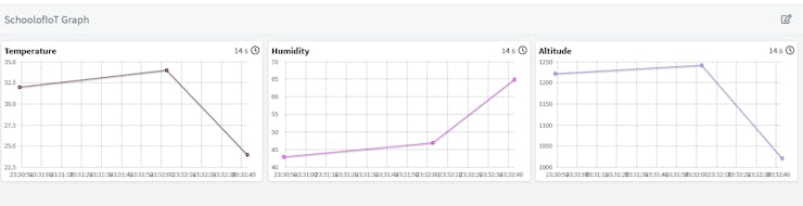

Step 7: Dashboards - Data Monitoring
When monitoring end devices, or controlling them, we need an interface to monitor all those device data, and visualize according to the type of data.
For example if we are monitoring the climate or surrounding of a device, using sensors to detect temperature and humidity, we'd need a time-series graph.

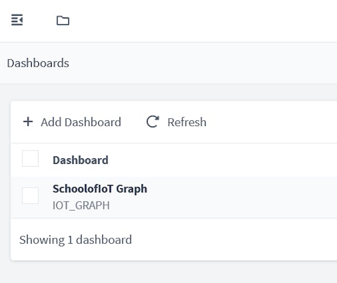

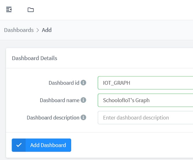

Add a new Dashboard, and give a name to that -

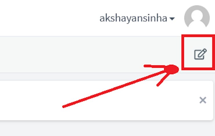

Once the dashboard is created, open the blank dashboard, and on the top right corner, click on 'Edit' button, which will reveal other options.

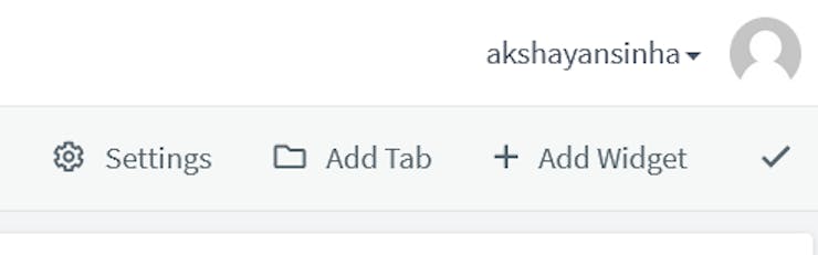

From here, click on 'Add Widget'.

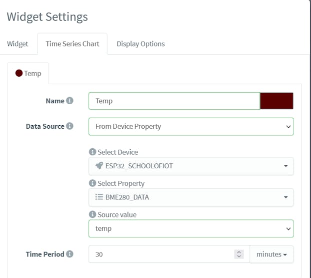

Enter the configurations according to your requirement, based on the payload data.
Once all the widgets have been created, we can view the graph in it's default value as per device property.

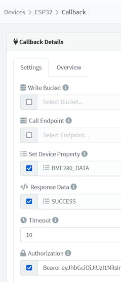

Step 8: CallBack Function

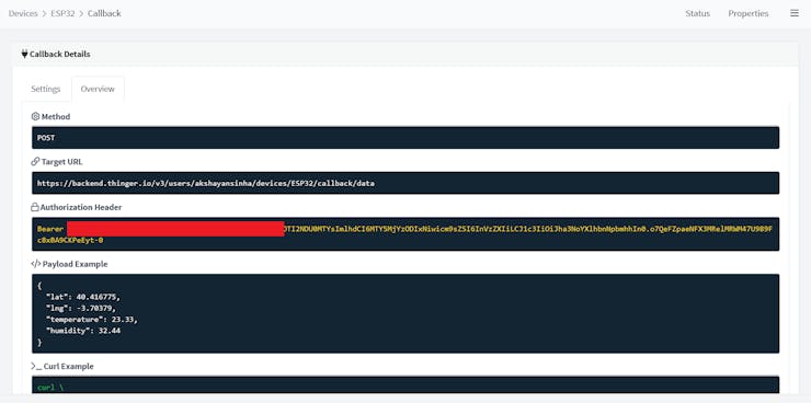

To be able to make an HTTP Request, we need the endpoint and a sample of the payload, that the Platform's backend would receive so as to display on the dashboard.

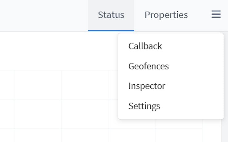

- To view details on the callback, search for the callback tab (current version - top right corner dropdown)
Now open settings and select the Device Property we created. Enter the details provided below.
Click on 'Save' to make sure the end point of the server is ready to receive data.

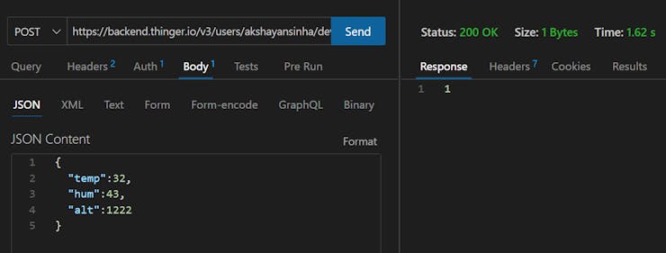

For testing, I used an API testing tool 'ThunderClient', and noticed that it worked great.

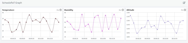

After a few different data on the content, we could see the variations in the time series graph.

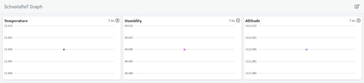

After pushing the data, from ESP32 Dev Board (2 mins later),
