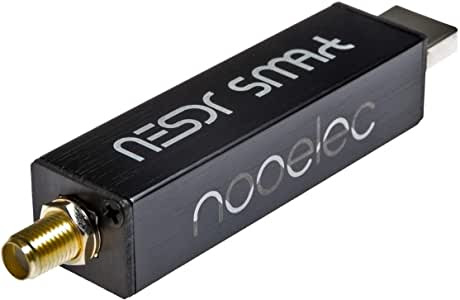

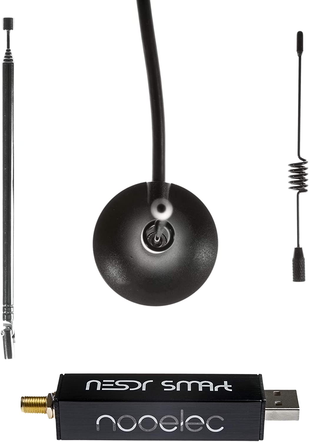

You will need an SDR
NooElec SmartSDR or RTL-SDR blog V3 are great to start with and around 30GBP or USD
